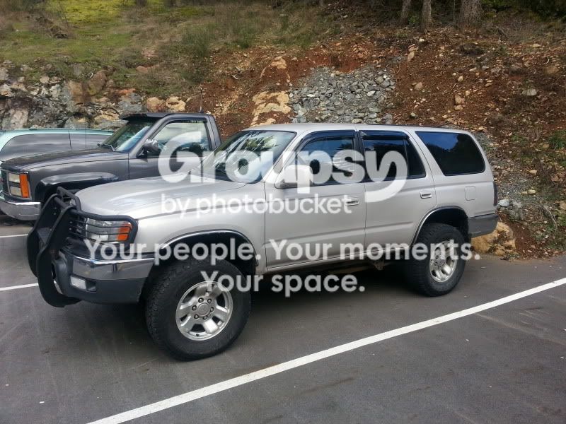

2" 4Crawler body lift
Trail gear sliders welded to the frame
Tundra 13WL Brake upgrade
waag brush guard

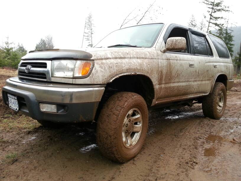

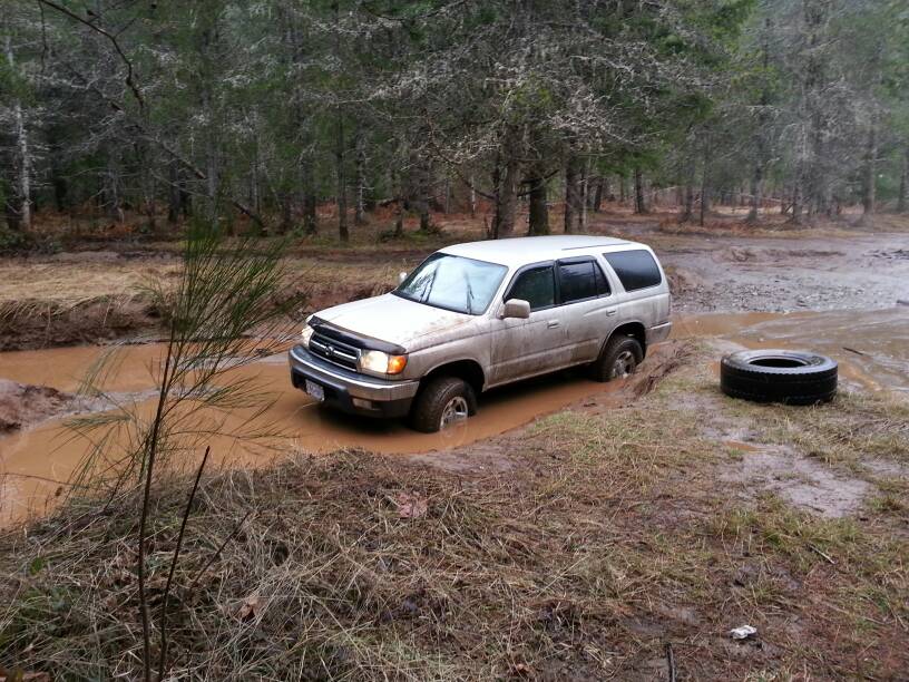

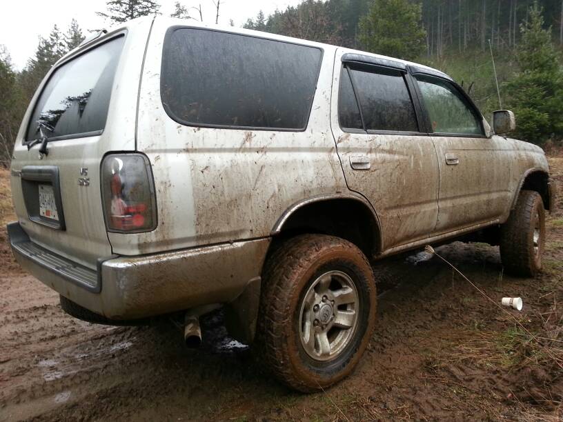

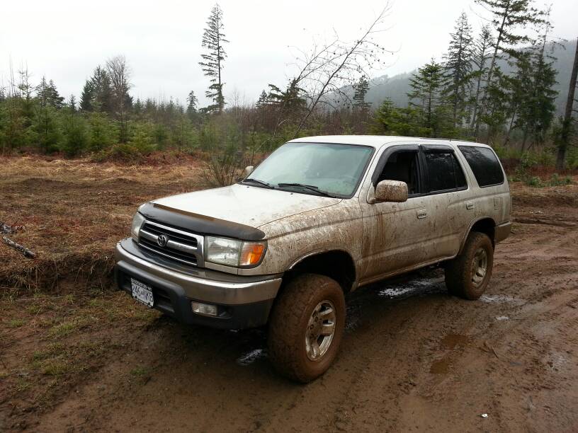

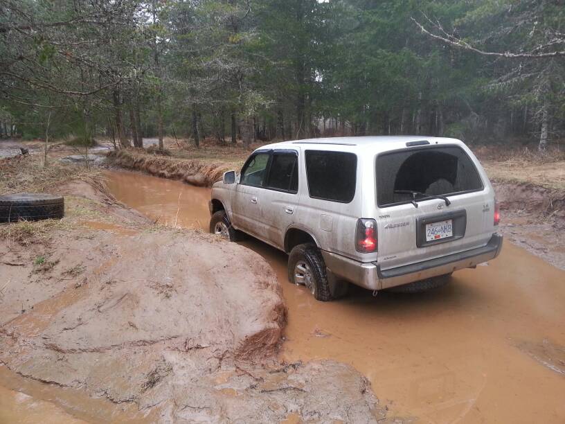

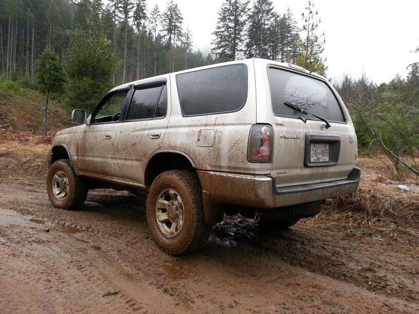

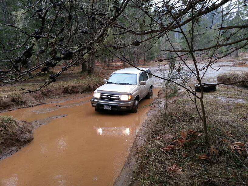

So the time came to get her out and do some mild wheeling as 4crawler suggests to make sure I got it all right lol.

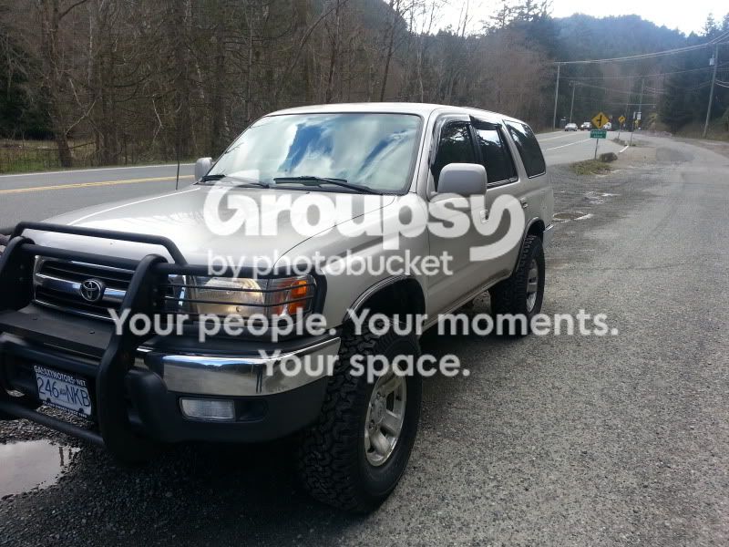

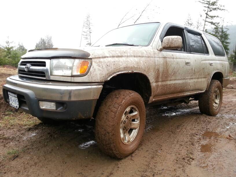

Well I did it. I wanted to see if the 285's would fit with my 2"BL I needed tires and didn't want to wait untill I got my lift. So the nice people at westcoast tire offered to test fit and help me **** around. Well doing that they sold a set of 285 bfg at to me!!!!
Before
20130308_133131.jpg~original
After
20130308_144105-1.jpg~original
