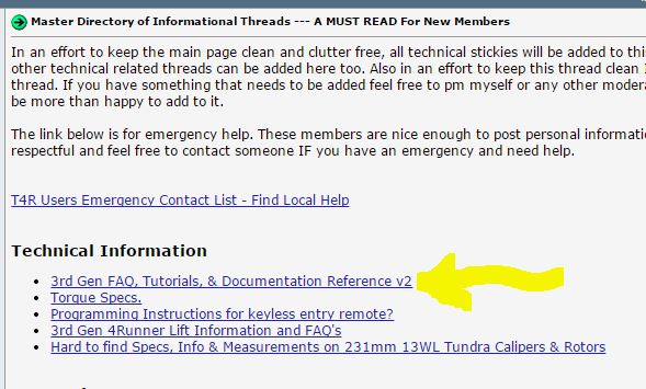

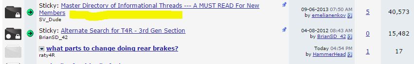

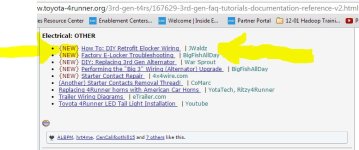

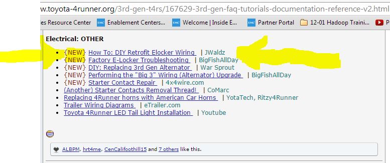

Just in case you haven't seen it ........
Have you checked out these TWO threads?
:plane:
Have you checked out these threads?
:plane:
I've done a ton of google searches. I did not come across that elocker troubleshooting thread though. Don't know if the magnet polarity issue is mentioned there but I just found out thats my problem.
