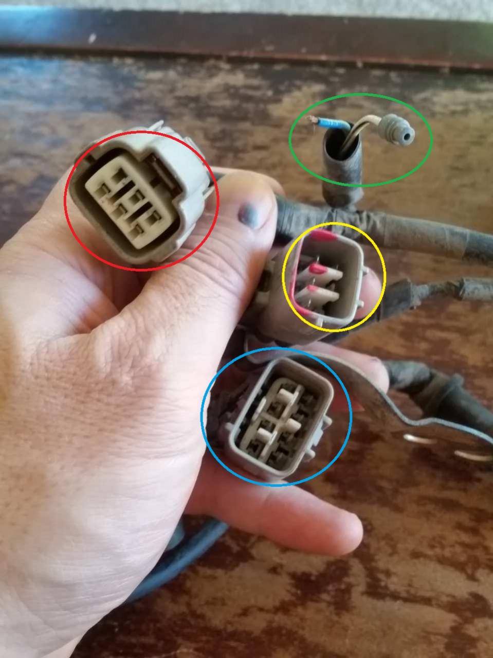

Need a little help. Grabbed an elocker/axle off a '99. I'm swapping it into my '98. I had Zuk go through the gears. Wish I had brought the actuator with it. Anywhooooo, This has 3 plugs as one can see in the picture. There also appears to be a plug missing.

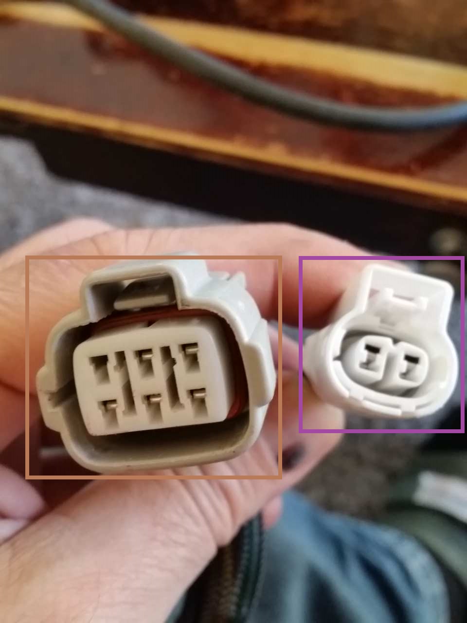

I don't believe my truck came pre-wired for an elocker. So i bought the Dark Illusions wiring harness. Looks well made. With that in mind
1. What are each of these existing plugs for and what do they connect to?
Red:
Green:
Yellow:
Blue:
2. What do i need to repair the missing (Green) plug, if needed? Do these have a particular name? Should i get it oem? p/n?
3. The second picture is the Dark Illusions wiring harness. It appears the brown plug goes to the yellow connector. What about the purple one?

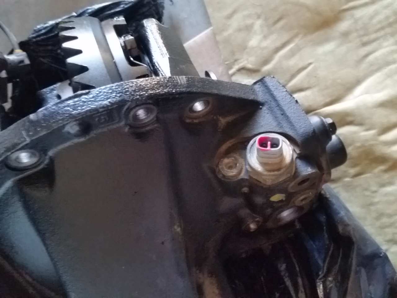

I feel a bit stupid (understatement). For anyone else new to this, here's what I found. I don't need any of the other plugs on the diff actuator (ie, blue, red, green circles). I'D STILL LOVE TO KNOW WHAT EACH IS FOR if anyone cares to chime in.
The (yellow outline) connector is to activate/deactivate the locker. The other plug (purple outline) attaches directly to the differential. See the picture. It's for the differential lock position sensor.
Warning. With the actuator removed, i bench tested it. It turned one way (likely to the locked state). It won't turn the other way, and i've just learned i need it back in it's original position to re-install.
Can anyone tell me how to get it back to the unlocked state?
(update). there are 5 pins on the actuator plug. the row that only has two pins is what you'll use to connect a 12v power supply. if it doesn't turn when you connect your power leads, immediately stop. you don't want to keep power to the actuator if it won't turn. now, reverse the power leads on the pins. it should turn the other way. easy.

yup. because im not using the ECU, the Dark Illusions wiring harness allows all the same options by default.
