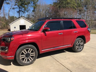

I never realized how old this thread was! I’ve been trying to slowly remove some chrome from my Limited.
I removed my Limited side pilar model labels off of a 2016.
They are only held on with two sided tape. A hair dryer heats it up. The dental floss either cuts the tape or gives you a way to grab it and delicately pull it off without scratching your car. You can then delicately pull any residual tape off with your fingernails. Then use goof off to rub the rest of the tape and adhesive off.
I polished it with some Maguires scratch remover 2. And then waxed it. Looks good!
These came off a 2016 in 2021. So on there 4-5 years. You can only see the faintest trace fade shadow of where they were and would have to know they were there.
I also removed the wheel caps and gently removed the Toyota chrome logos. I replaced them with stick on 2” solid black wheel hub caps to cover the mounting holes for the chrome logo.
