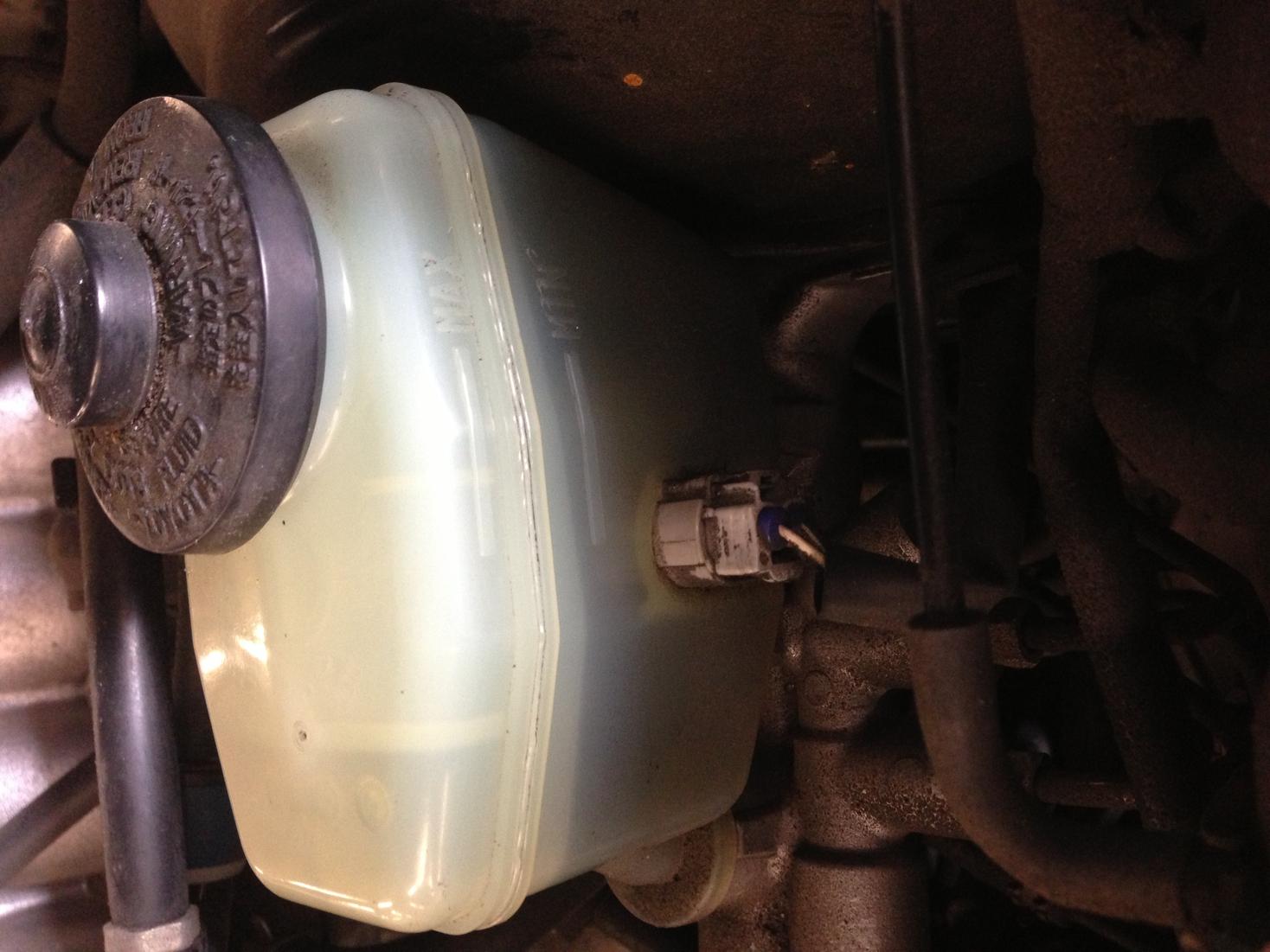

I have same issue that just started. Randomly coming on. I just noticed it many comes on going down a hill or if I hit brakes hard and the nose dives.
Fluid is here. Im going to top off to max and see if it fixes.
