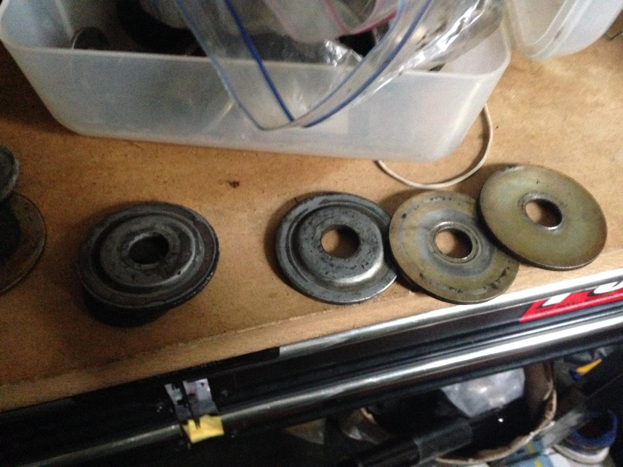

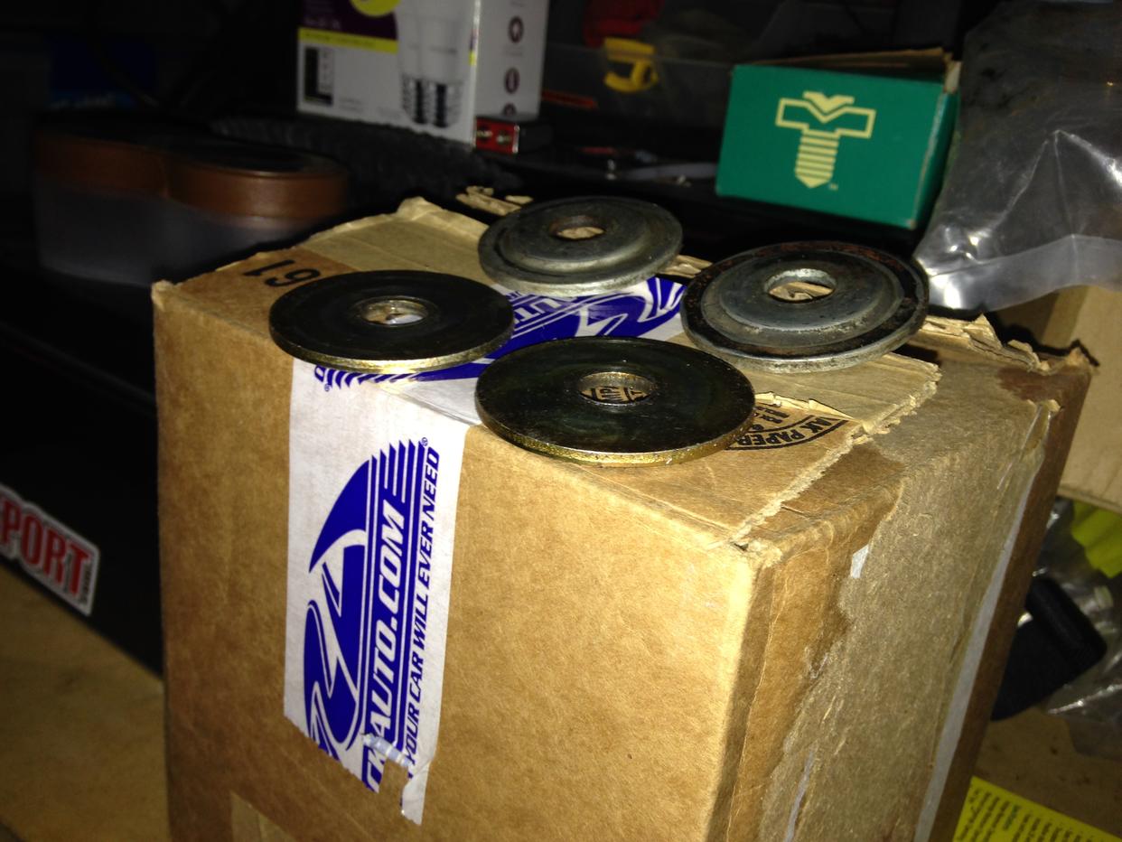

Thanks for confirming that. So if the washers are on the ends how do I make up the gap between the inner bushings?
When I installed my ES UCA bushings (into OEM UCA) I had a small gap between the frame and the bushing, which was taken up upon tightening the UCA bolt and nut. No issues.
