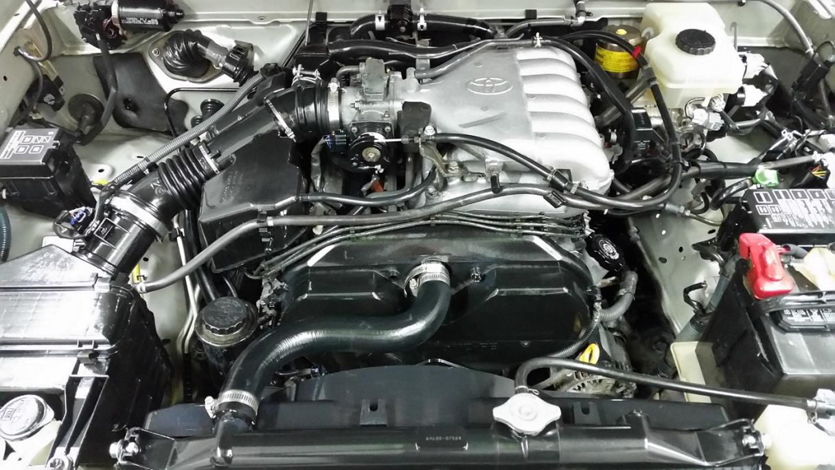

I have used simple green for decades with NO adverse effects.
270 k miles and it still cleans up nice.
I admit, I never knew about Simple Green affecting aluminum... but I guess I just never got around to cleaning bare aluminum with it.
Good to know about that though. I've used SG for pretty much everything else in my life, lol.
