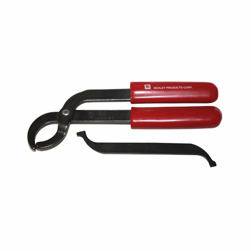

I've done it both ways, both pulling the camshafts and not. When I had the 3VZ-E engine I did it with the tool. It has a VERY steep learning curve that's extremely frustrating but once you get the hang of it the job gets easier.
I did the valve adjustment on my 5VZ-FE engine when I installed a set of performance camshafts and since I was taking them out it was simpler in some ways but not in others. I did the timing belt as the same time to make the hassle of lining up timing marks and all that worth my time.
There is a 3rd solution though. The exhaust camshafts do not have a sprocket on it and are fully contained in the cylinder head. You can very carefully thread a valve cover bolt in the threads on the spring-loaded intake camshaft gears and then, in order, remove the camshaft brackets and the exhaust camshaft. This then allows you full access to all of the exhaust shims without using the tool. Can be useful if that's all you have to do but the process of removing and installing the camshaft is extremely specific that I don't recommend doing it unless you read up on the FSM beforehand. It's also very easy to strip the aluminum threads in the cylinder head.
OMG no one in their right mind would pull cams to do valve adjustment!
The best tool is the Toyota SST 09248-55040 (09248-05410, 09248-05420)
grab a pocket screwdriver and a telescoping magnet.. maybe a pick as well.
Worst part is getting shims from the dealer. Doesn't Tim the Tool have 50 videos on this??
