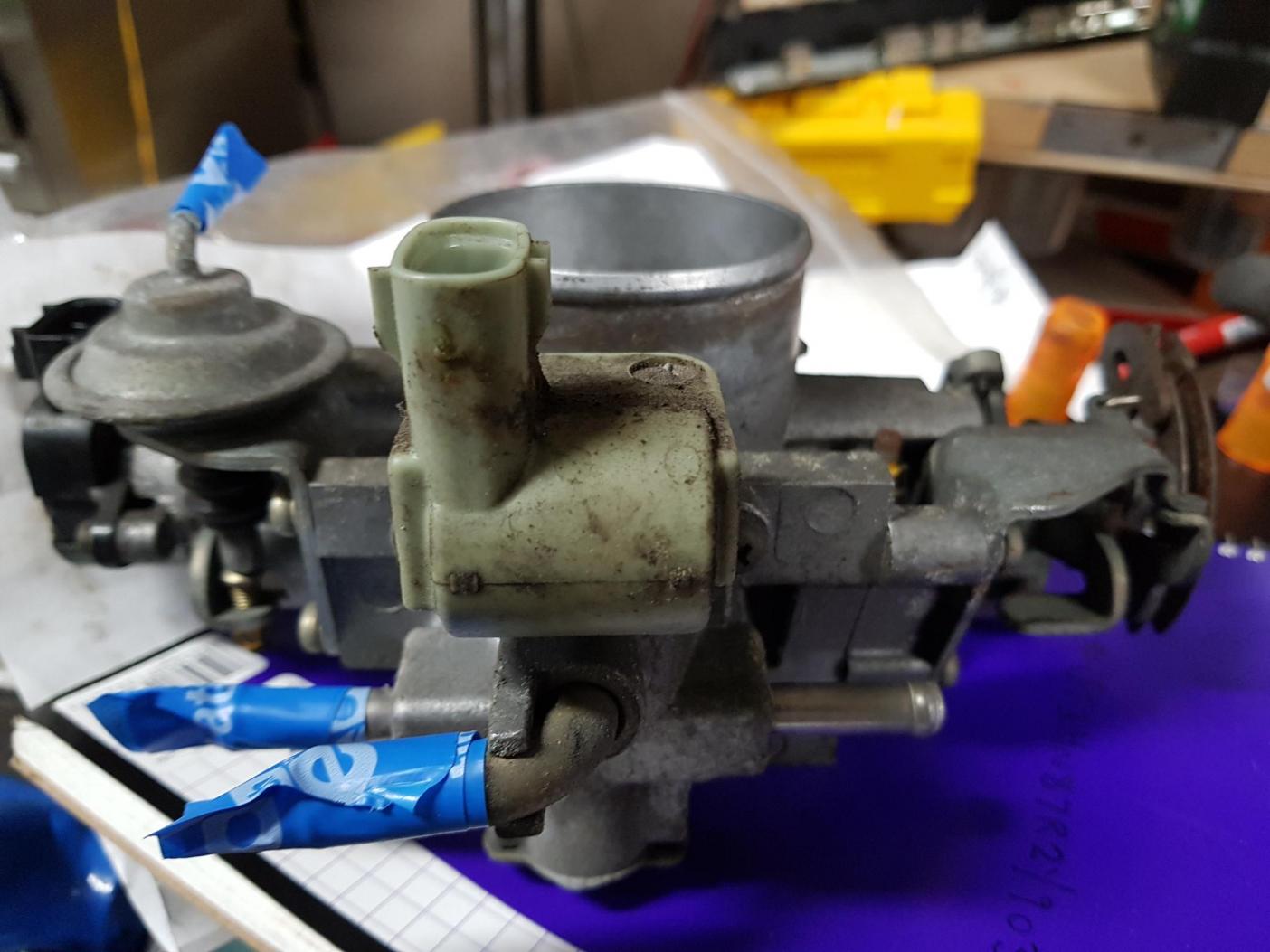

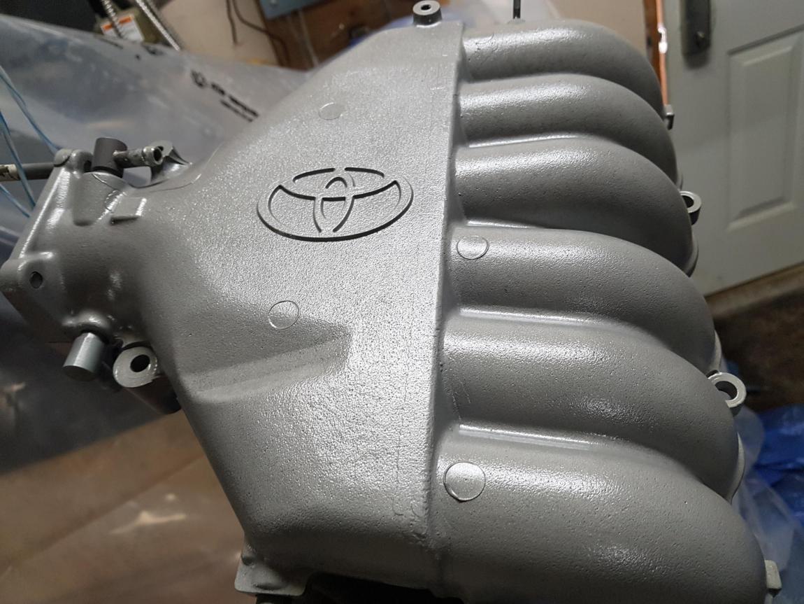

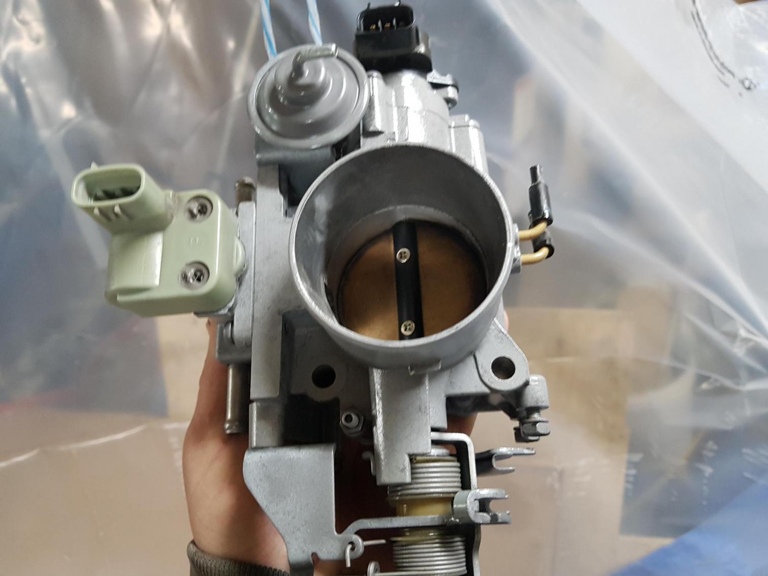

I also used crushed glass, it's so gentle I hit the plastic electrical connector and it did no damage. These were bead blasted, washed, wiped with acetone, adhesion promoter, then clear.
That looks great, thanks for the tip! Can you elaborate on which adhesion promoter and clear you used?

It's been about 5 yrs since I did that work but I think it was just dupli color adhesion promoter, I used some off the shelf clear from home depot and it has started to yellow a bit now. If i was to do it all over again i would use the VHT high temp gloss clear for brake calipers. I used that on my rear drums after painting them black and it has held up great. Those valve covers look clean. I did my valve covers and intake pipe with the VHT wrinkle Black paint but obviously powder coating is superior, I had a set of FJ wheels and Tacoma wheels refinished and powder coated and they came out great.
