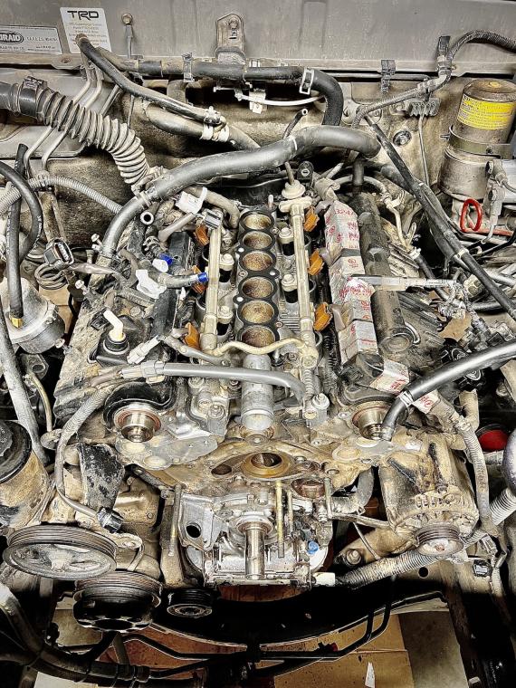

Timmy the Toolman and Sean are starting an engine Engine Bay Refresh ourselves....
