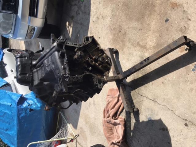

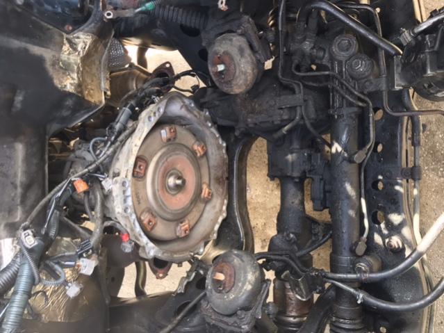

continued from yesterday as i needed to get some 5 pt sockets as to not mess up some bolts that were a little rusty. but got the engine out, chipped the corner of it where the dowel is but what can i do. gonna eat something and than open the bottom up see what i'm working with.
never did find a solid answer if you can bore these if their was a little contact from piston... so need to find that out. but more info once i open it up later tonight.

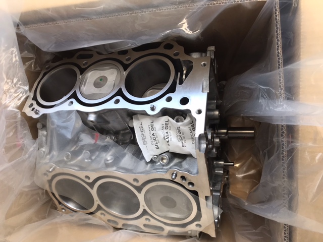

man what a ride to get this thing done....
luckily i like to research alot and recently found cheaper oem parts through the dealer so during my research came across the part#1140039135 which is the short block. saw one on ebay which included everything, so i hmmmmm wtf, thought i was told its just the bare block. so called two toyota dealers to confirm part#1140039135 is for short block assembly 1grfe. has pistons, crank, rods, bearings, etc. my total with tax and discount of 25% parts sale came out to about $2500. so hopefully get it in a couple of days as it states they had it local.
Hell yea man, $2500 for a complete bottom end assembly from toyota is honestly not bad one bit and is bound to save tons of time and stress in making sure you assembled yours correctly after getting all the machining out of the way.
So picked up this bas boy this morning, taking the heads back to the machine shop for inspection make sure those are good. waiting on a couple parts that i bought new to come in to start reassembly.

Can I ask how you got a 25% discount? That's awesome. I searched that part number and my local dealer has it for $3170 before tax. That's better than MSRP of $3899, but not even close to what you paid. That's a good deal.
Googled the part# with my city. And looked for the cheapest one. Had to drive 45mins away but got what need way cheaper than my local dealer. Parts store online for the ones I found had an online sale till today in the SE region.
Rod bearing went out, disintegrated. Piston slapped the walls so instead of Rebuilding what I had. Choose to spend a couple hundred more to start fresh. By the time I send the block and do the pistons etc wasn’t worth what I felt wasting my time to do the whole bottom end to spec. Let Toyota handle that part, and I just throw the heads I had redone on.
