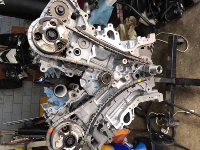

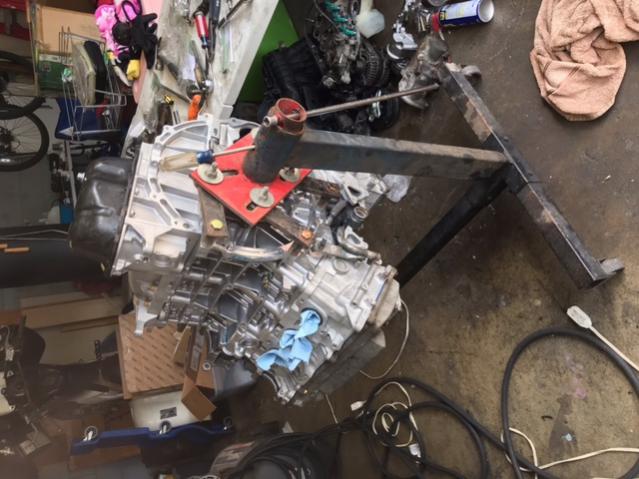

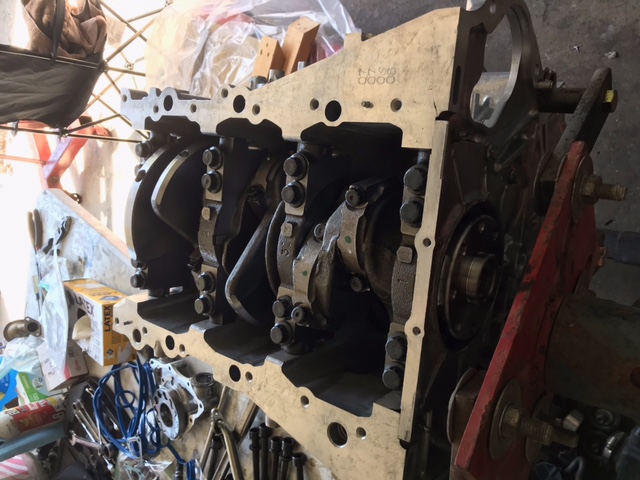

Been pretty busy lately but i've been antsy to put the block on the engine stand get the party going. Did that and sealed the rear plate with new sealant. Went ahead and bought a new upper oil pan as the engine came off the chains when i was taking it out during removal do to laziness basically. So during the sale i bought the oil pan as well. I'll post updates and pics as i go on with assembly. pretty sure its going to be easier to assemble everything, including the new motor mounts i bought to have a line of sight to line it up with the tranny. Slowly but surely will get it done and hopefully back running within a week or two.

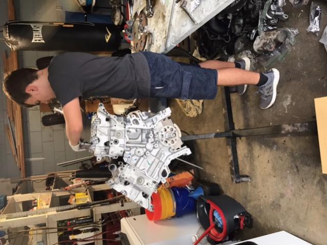

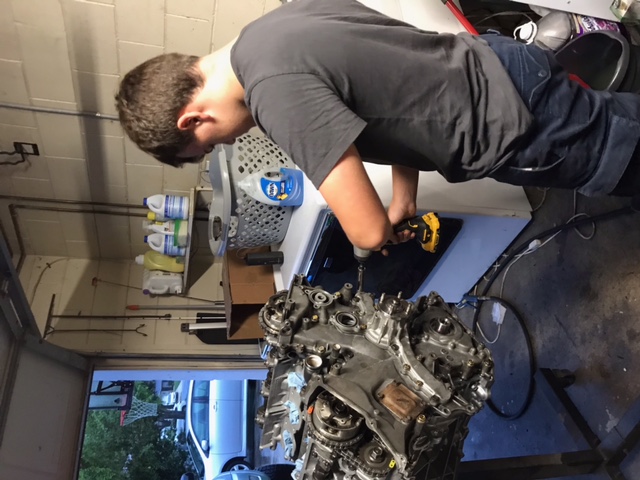

Soon as my kiddo got home from school, we went to wrenching, spent about a good hour and a half on it, explaining to him some components and how things work as we went along. Had him use a torque wrench and he did the head bolt, as well as made him tighten them 180' turn. He struggled a little but he persisted to want to do them all himself.
Literally had one bolt left on the cams, and i freaking dropped it inside the head, so had to disassemble one side, and low and behold the bolt was sitting on my shiny new piston. So put everything back to where me and the boy left off, of tightening the cam bolts, theirs just hand tightened right now.

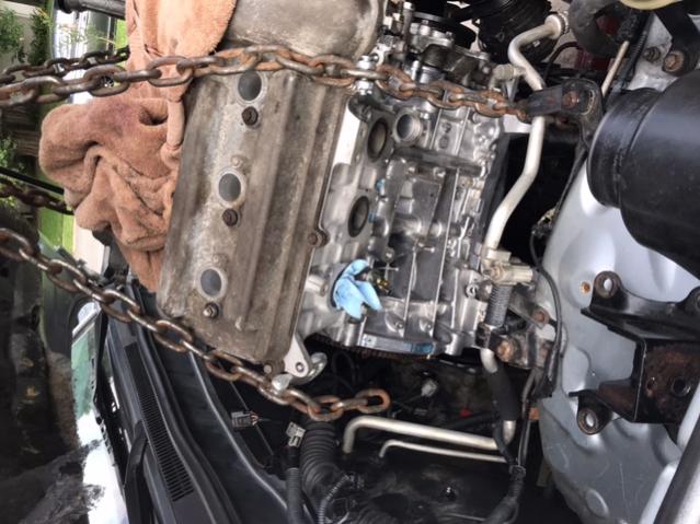

So between last night and this morning we finished putting the heads on, valve covers, lower oil pan, and smaller oil pan. Engine is now sealed up, gonna put the motor mounts and than time to put it back in.

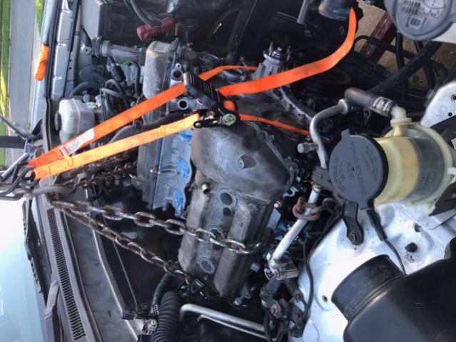

Today once the kiddo got home at 5pm, persisted to connect the chains and mount this bad boy in. once one dowel was lined up was able to wiggle the other one into place, once the motor was level with it. Actually had more trouble with the motor mounts than lining up the tranny. probably took a good 20 mins to line the tranny up. i had the boy tighten all the bolts for the tranny and we continued on with the motor mount. took them both off and lined both of them assembled together and than put all the bolts on. So far everything lined up good, Wiring and hoses and she'll be all done. i say by this weekend as i want the boy to finish all the work, so far hes done most of the major work.
