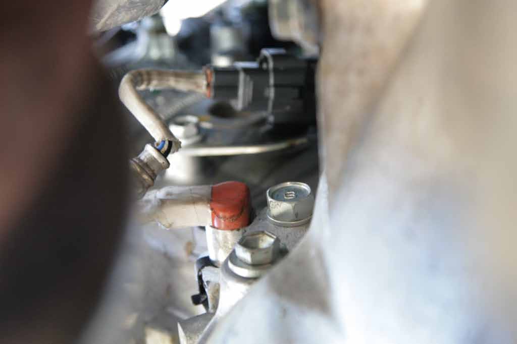

This pic shows the heater fully inserted into the hole. Notice the black metal clip attached to the engine.

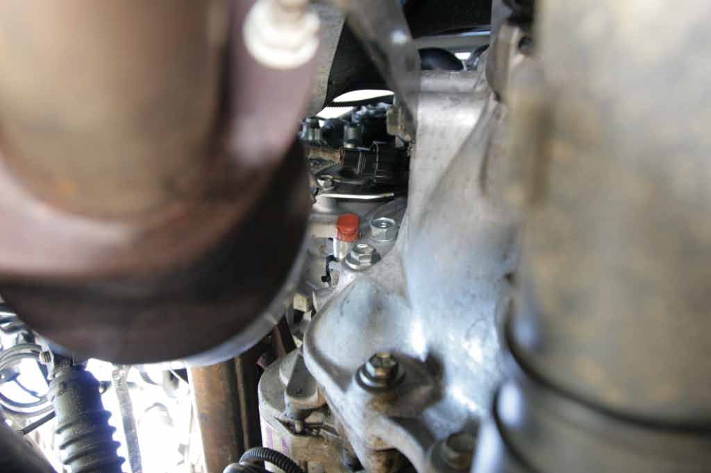

Final pic shows a wide angle side of heater installed. This is the view from under the truck again.
Well - that's it.
IMO - it should take about an hour to do this job (if the mech knows where the location of the hole is supposed to be). it took me a bit longer - looking for the place and taking the photos. My usual garage charges me $80 per hour - so I guess I save a hundred bucks or so.
Thanks for the help guys.

mjlmjl,
Thanks for the pics.
Now the questions.
You confirmed with the pics that it isn't threaded but a push/slide-in unit that holds with a clip. How tight is the fit? Does it slide in easy? Does the wire connetor clip on or is it a tight fit?
The reason I ask is because from your pics I can see the heat protective wrapping at the wire connector. I want to disassemble mine to fix up the wire wrapping to avoid burning a wire due to exhaust heat.

Yes - there were no threads on my heater. I just applied the gel/grease (that came with the kit) on the unit and easily slid it into place. I didn't have to push it too hard at all, except at the very end when the clip had to be pushed into place.
If you want to remove yours - just use a flat screw driver to unclip the black clip. Then - use a thin/slim vice-grip or pliers to extract the unit. It's a tight/snug fit, but should not require too much effort to remove it.
I used extra tie-wraps to fasten down the wire to ensure that it doesn't get melts by the hot engine/exhaust parts. It's good preventative maintenance that you're doing.
Hope this helps - let us know how it goes.
