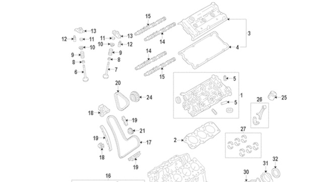

BS. Overhead cam engines don't have rocker arms lol.
I agree they generally don't, however the updated 1GR-FE does have them as shown in the parts diagram below part #13. And they're listed as "Rocker Arm". It's a spiffy lash management system, no mechanical lash adjustment like the previous 1GR-FE but it may be noisier given the extra moving parts.
