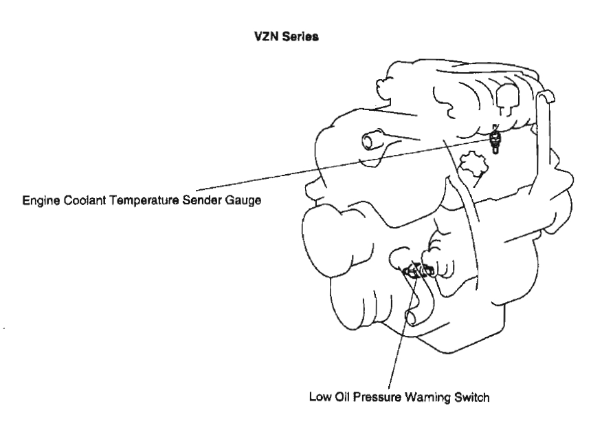

You probably yanked a wire. I believe the sensor for the dash is towards the back of the engine.
There are 2 coolant temp sensors. The one for the ecu is on the front of the block. The one for the dash is on the back of the block.
yup, i think it is the one on the back of the engine. FWIW here is a image i got from a mechanic friend of mine, under the lower half of the intake manifold.
