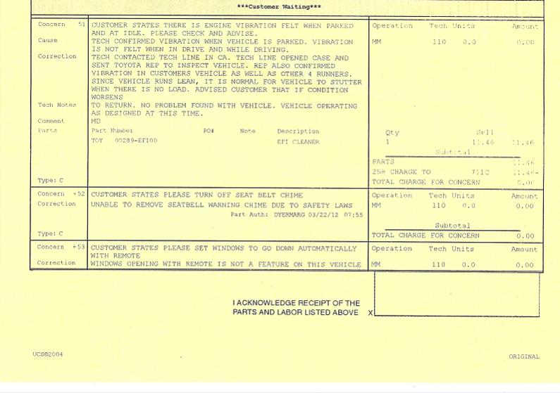

Sorry for the late update everyone. So basically I got my 4runner back as stated in the receipt below this is suppose to be normal which I know is not as its too much vibration felt inside. The reason as stated below about why i feel the engine vibration is its running lean. I also tried to get the seatbell warning chime to be turned off and Windows to go down from the remote and they said no.

Your dealer is full of crap. :toilet:
Ducmonsta programmed my windows to go down with the remote when I visited his shop by using the dealer's techstream software. It is a feature for your vehicle.
Go to another dealer that knows what they are talking about. I swear, this world is full of idiots- the older I get, the less tolerance I have for them...

There is nothing grumpy or intolerant about not loving being lied to. I would go back to the SAME dealer and demand a apology while they do it for you.

I don't have the TBS# right now. However, your pointing out that they did use some EFI cleaner would seem to indicate they are aware of TSB. I think TSB requires throttle body to be cleaned from the inside maybe even disasemblied, not sure. In any case consider the following:
1-Go to service depart and request to speak to shop foreman, and only shop foreman.
2-Request to see TSB and review with foreman to see if the person who worked on your car followed instructions.
3-The TSB# are available to people who subscribe to various programs like TIS. I suspect Alldaty DIY may even have it listed.
4-If that doesn't work consider enlisting the aid of the Dealerships General manager, assumning you purchased from that dealer.
