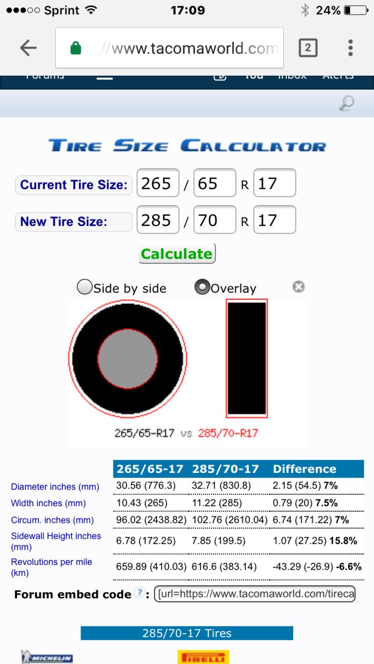

Reading your previous posts is why I am lost as to what you're trying to accomplish. A 1" lift isn't going to net you any real clearance... you'd be better off going with a 275 tire to get that subtle change in clearance.
I totally understand avoiding changing out the UCAs and from what I've gleaned, anything approaching 3" or more lift will necessitate new UCAs to get a good alignment. I'm looking to lift mine about 2", but I think I'll be going with a spacer for cost reasons - and I expect my factory struts to last 100k miles.
Changing to a 275 would yield .25" increase in clearance, if that; that is why I am looking for a suspension lift, which provides much more tangible benefits IMHO.
I'm not looking for a spacer kit. I fully expect toyota's stock suspension to last 100k or more under normal driving conditions. But given where i've gone with my stock rig, and given where I plan on going in the future, I would like to have newer components, with a little bit more lift...it's a peace of mind thing.
