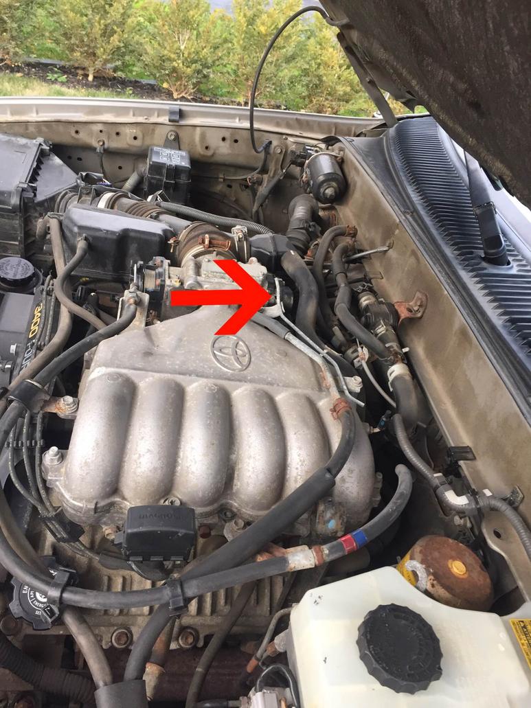

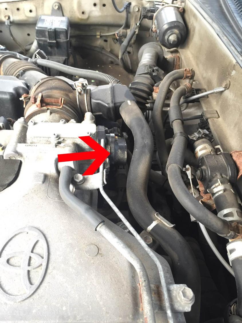

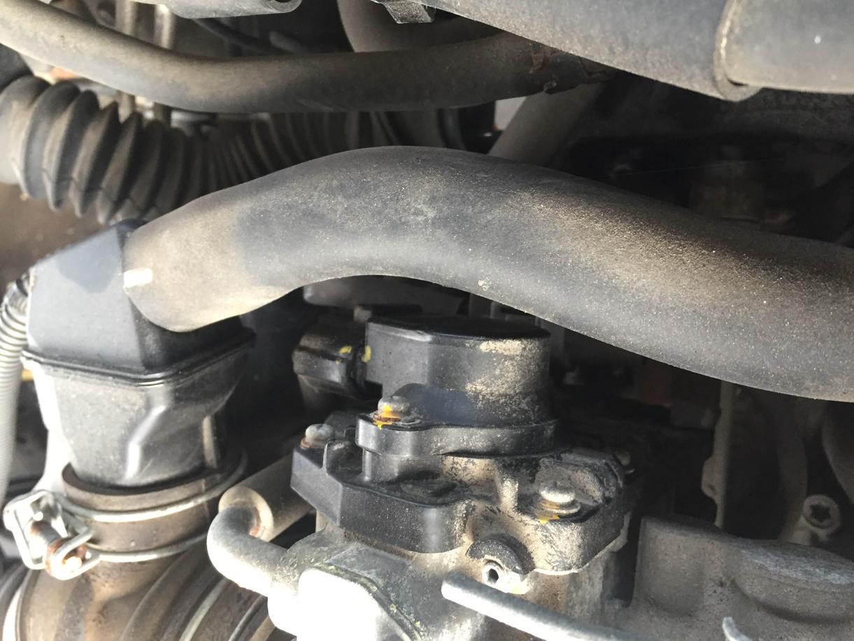

I have attached pictures of what my mechanic pointed to when he was explaining the issue.
MY QUESTIONS TO YOU ARE:
Since apparently it can't be called the EGR since they didnt have them post '96, what is the part that is shown in the pictures.
And could this part be the root of my EVAP and CEL problem??

Looks like the TPS (throttle position sensor to me. As far as I know EGR's were only on 4 cyl 4runners. Not sure what years or if all years of 4 cyl.
