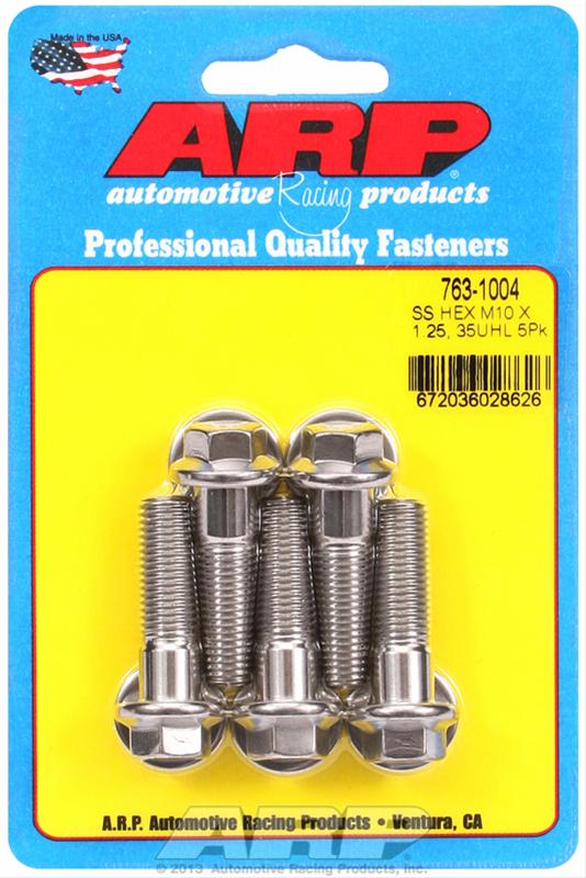

Any thoughts on the stainless ARP bolts? 763-1004 in particular...
Curious what the difference is between the stainless 763-1004 versus the 663-1004/673-1004.
I bought the stainless 763-1004 before I read this thread... wondering if I should return them.
