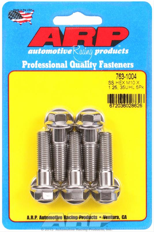

Any thoughts on the stainless ARP bolts? 763-1004 in particular...
Curious what the difference is between the stainless 763-1004 versus the 663-1004/673-1004.
I bought the stainless 763-1004 before I read this thread... wondering if I should return them.
You actually got a better option since the black ARP's are black oxide and folks have shown that they start rusting before too long.
The ARP stainless is still super strong. I got stainless studs from ARP for my LBJ install. I used the ARP lube and torqued to 54 ft-lb which is ARP's spec for that size fastener. I'd suggest doing some more research to determine what spec would be appropriate.

I'm thinking I'll go with the torque spec recommended in this thread for the black oxide bolts; around 65-70 ft-lbs.
It's up to you of course, but do consider that the torque spec for the black oxide bolts is set for a higher strength fastener. The ARP SS is just a touch higher strength than OEM, and it doesn't have the fancy low-CoF coating of the new black OEM bolts. I might use the spec for the standard OEM flange bolts...
I have a set of the ARP stainless bolts on hand, as well as their lube, which I plan to test soon to get the torque-preload relationship, as well as measure degradation with repeated cycling. It'll take me a while to get to that though (life gets in the way of fun projects sometimes).
If you want to install the stainless bolts before that data comes in, I probably would limit the torque to 50-60 ft lbs if installing dry, without lube. My thinking is that if they recommend 54 ft-lbs with their lube, then you'll be getting a lot less preload without the lube, so not much risk of overloading the bolt unless you start going well above 54 ft-lbs.

Ok, so I’ll plan on 60 ft-lbs with the washer and blue thread locker. Appreciate the feedback.
