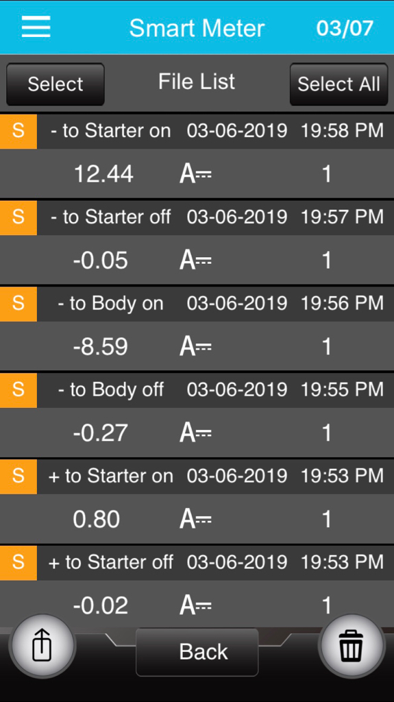

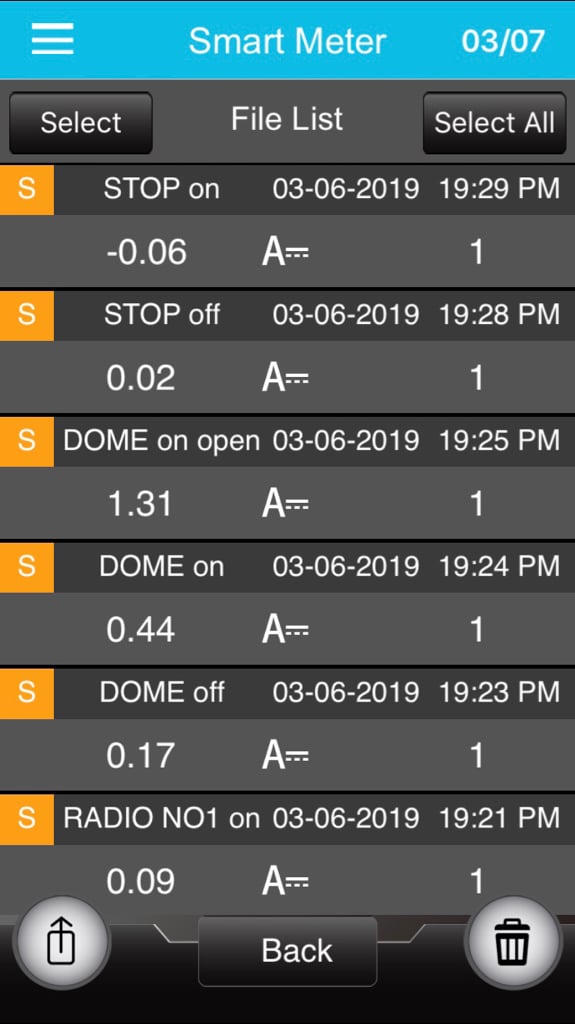

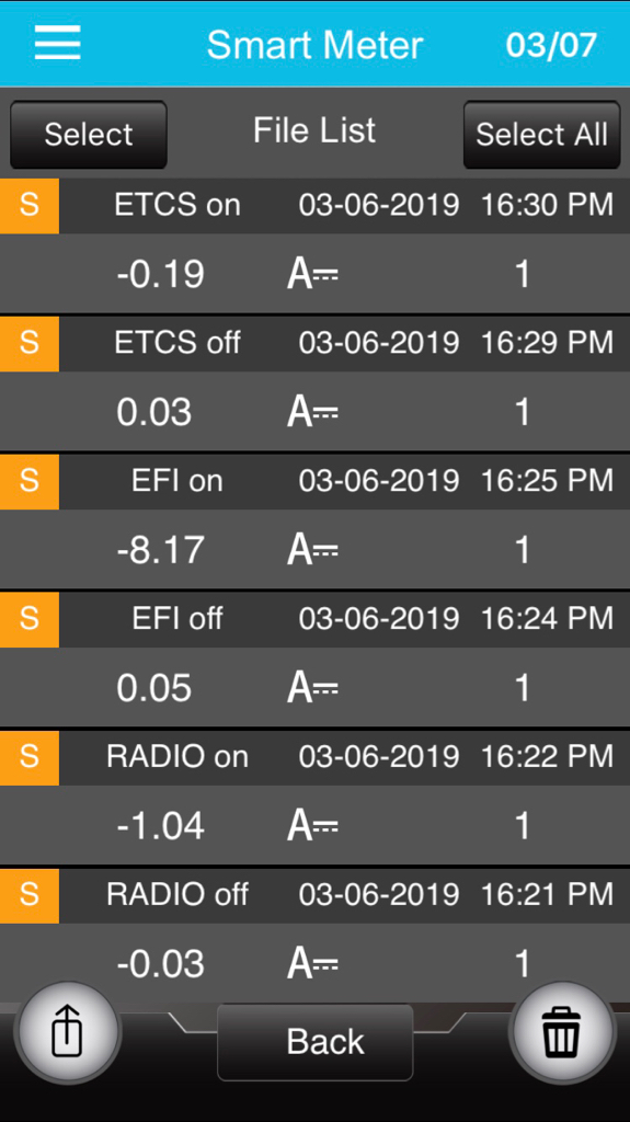

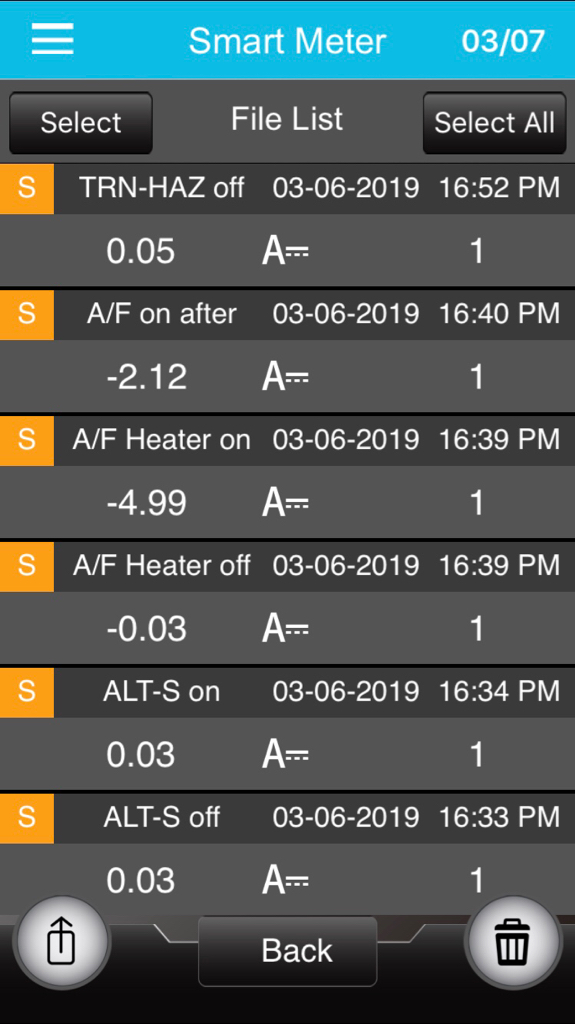

Got an amp clamp and did some testing.
Not sure if I found anything relevant yet, thinking I’m going to have to test on the road.
Just did most of the under hood fuses so far.
Tested with vehicle off then running, then some engaged while running. Reved past 3k rpm with some but it seemed to have little to no effect
Basically my test flow starts at bottom and goes up to the top pic. This was my log.
Most interesting is the top one just below.
Starter on, this with it just running, not pull on startup. This is the negative that runs to the block next to the starter I believe. Could just be the path for returning current from other engine grounded bits.?

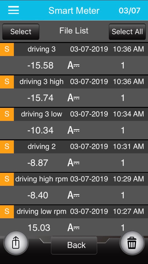

Just did a test drive with the clamp around the negative cable. One test with it on the engine ground from the battery, then one with it on the body ground.
Basically it’s happening around or above 3000 rpm.
Top 3 are together (body ground). Bottom 3 are engine ground. Both have one low rpm result, then recorded two high rpm results.
Odd how bottom results (engine ground) flips direction by 20+ amps.
