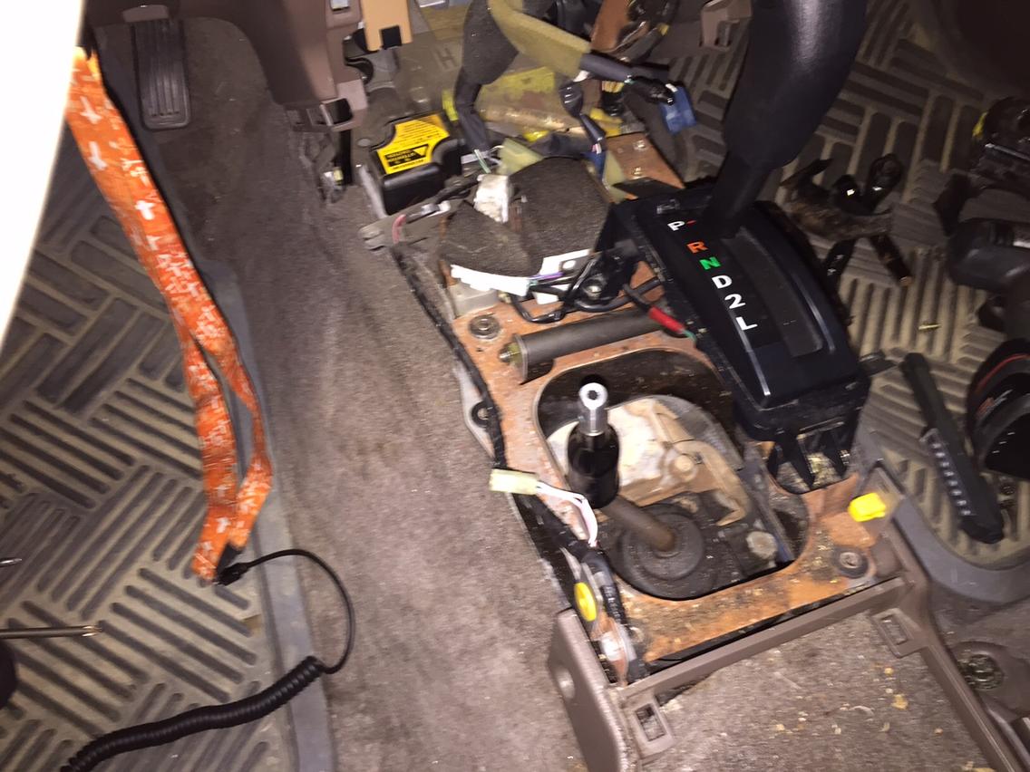

UPDATE - I think I found the problem
I pulled the center console to find that majority of the rubber boot where the transfer case shifter comes through was missing! So of course that's where the heat was coming from. My question is in regards to the amount of heat. Is it normal for the transmission and/or transfer case to get so incredibly hot?

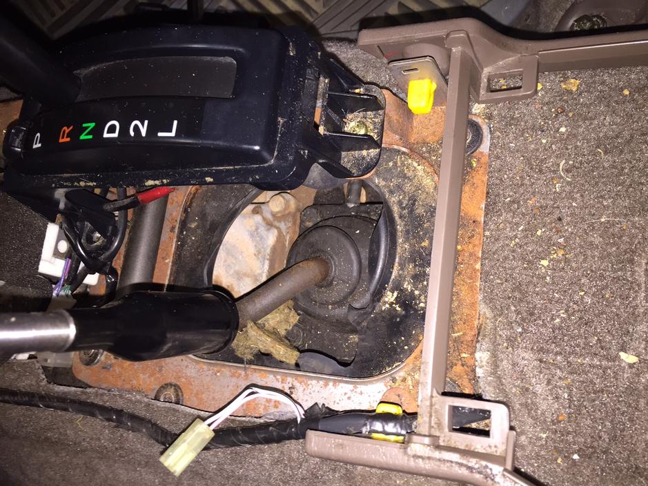

FIXED IT!!! (for free) :-)
SO here's what I started with... I've learned that the transmission has been replaced in my T4R and obviously the idiots that did it were't smart enough to take the transfer case shift knob off the right way so they just cut away the boot attached to the floor!
So I unbolted the plate that holds the shift linkage as well as "sandwiched" the original boot into place and removed the rest of the damaged boot.....
