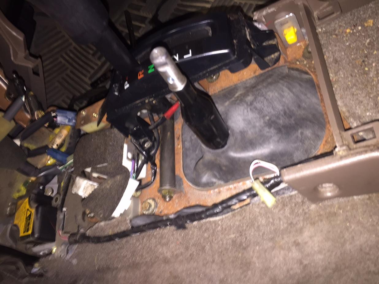

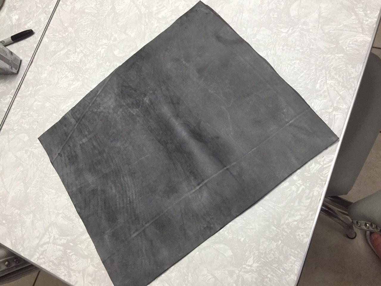

After going down to my local tire shop and asking if I could grab one of their old damaged tractor inner tubes I cut out 16"X20" piece.....
After laying it over the console area and marking a spot to cut a slit for the lever to come through, I slipped the large piece between the linkage plate and floor the loosely "sketched" around the plate but mades sure to do it about 2" outside the edge so that once installed it would leave a little slack in the middle to allow moment in the shift lever. Here's the finished product.....
