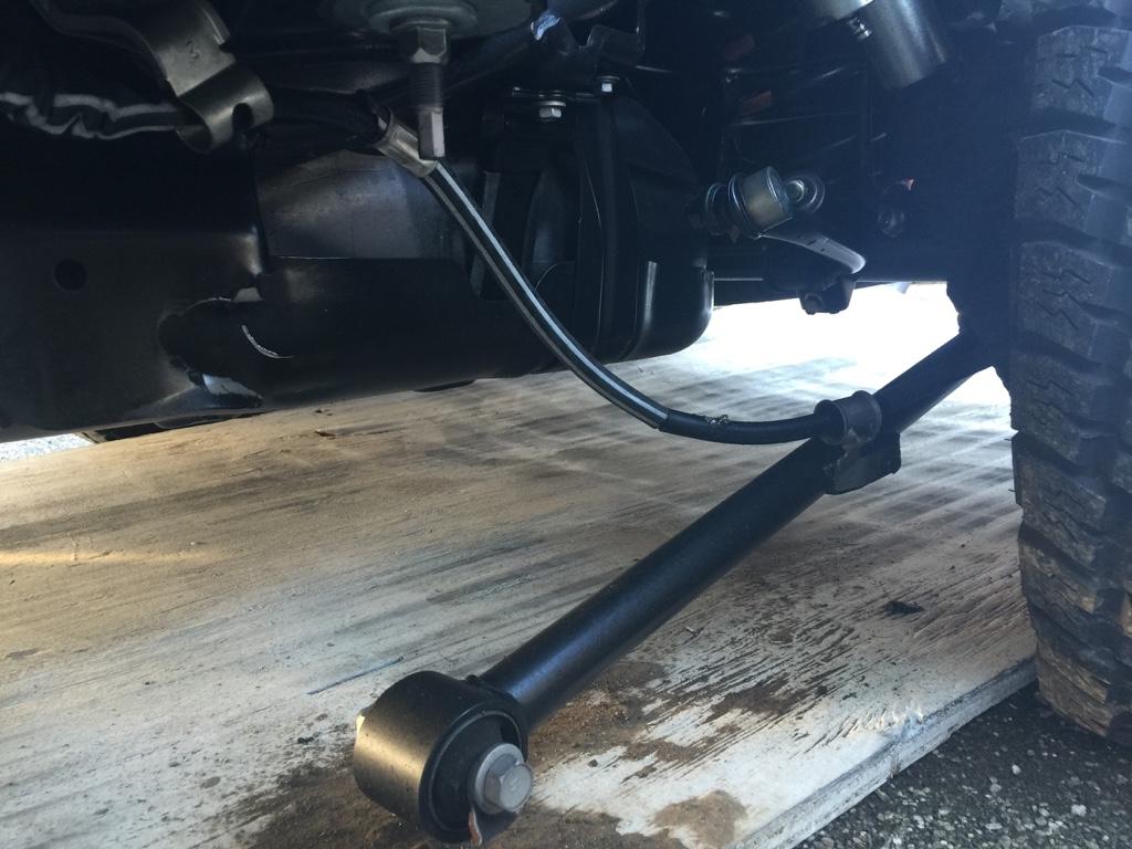

Repairs in 2016: control arm mount replaced remounted, replaced control arm, rear axle shaft

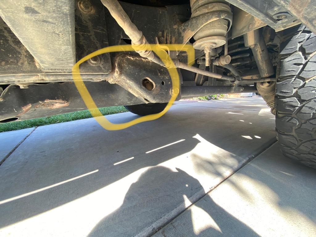

Control arm mount not welded perfectly?

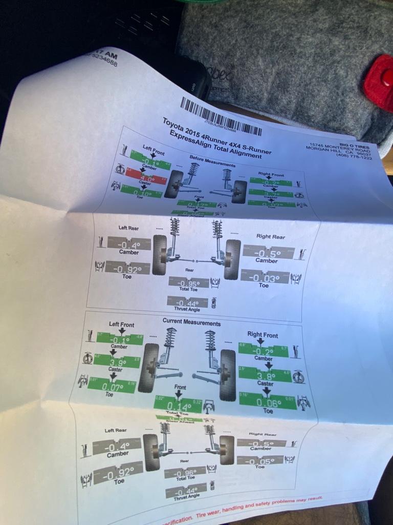

Latest alignment

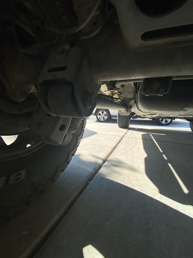

Rear control arm mount now

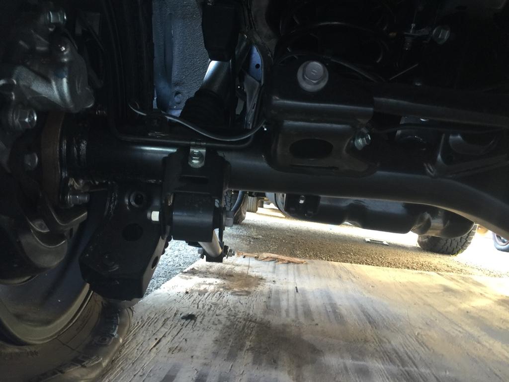

Damage in 2016
It's unlikely the rear arm has anything to do with it. If the axle was located improperly, you'd see the inverse on the other wheel since the axle is a solid member across.
Most likely cause is a bent axle.

Your straight axle is bent. Negative toe on one side has to equal positive toe of equal amount on the other side if you have a straight axle. Repeatable alignment numbers confirm this. If you had just a bent frame or improperly welded control arm mount then adjustable control arms would be an easy fix to compensate.
