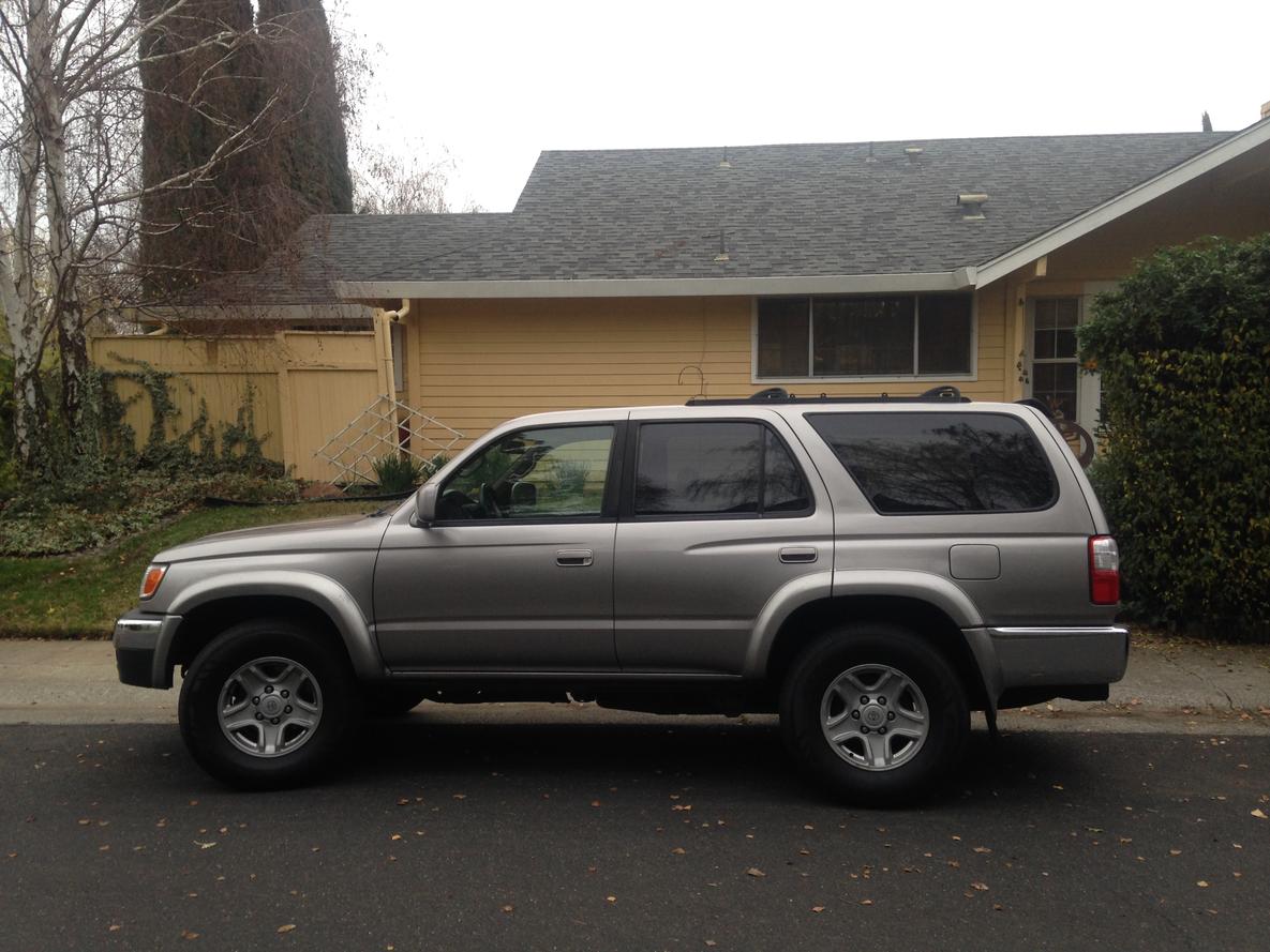

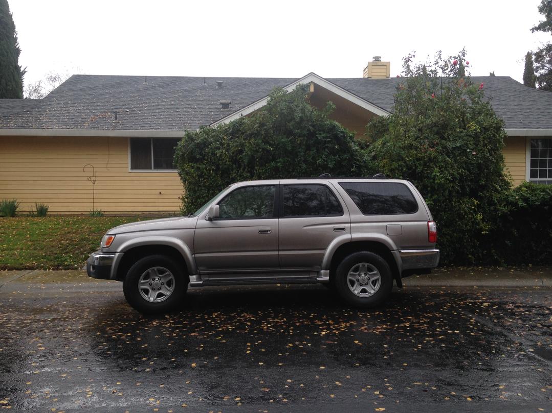

Just bought my first vehicle last week at a local used car dealership. I got it for 8000 which seemed reasonable for a 2002 Limited with 180k miles. The car is pretty much perfect apart from a few minor issues.I couldn't wait to start working on the runner, and by the end of the next day I took of the running boards.

Whether you paid a bit more or not for your 4runner, its beautiful and its about getting what you want. Sometimes to get what you want and get one that is already in the shape you want you gotta pay more than what the "book value" is. I live in BC where yota's are worth more than most other places... I had to pay $8000 to get my 2000 5 speed. It has less miles than yours but not that many less. The fact was I wanted that EXACT truck and I wasnt willing to wait another 2 years to find another one. I probably wont get out of it what I put into it but I didnt buy it to get my money back I bought it to be my truck. Just think... you could pay 40 grand for a brand new 4runner or you could pay 8 grand for a 4runner that is basically just as good and in damn near new condition (and looks way better).

Another little thing. Your 4runner is actually a truck. A body on frame masterpiece of rugged refinement. You might hurt its feelings if you call it a car. :p
