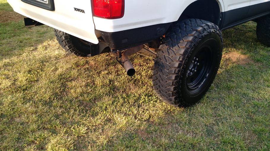

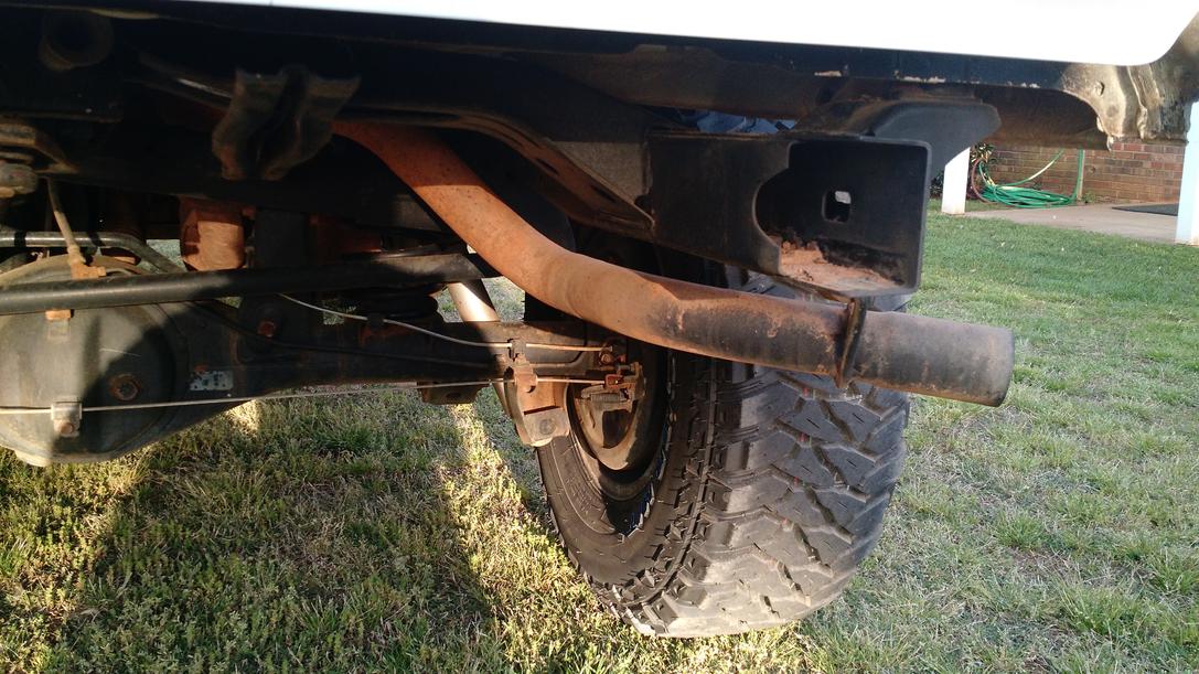

I took my rear bumper off God knows how many months ago and the exhaust kills me because of how far it hangs down. Anyone remount their exhaust on the back end?
The argument against that has always been the charm of running with the back window open and the risk of filling the truck with CO gas if you stop at a light with any kind of a tailwind.
I put a different exhaust on and have it turn down before the axle. I also added a resonator tube to cancel out the drone around 2000rpm.
