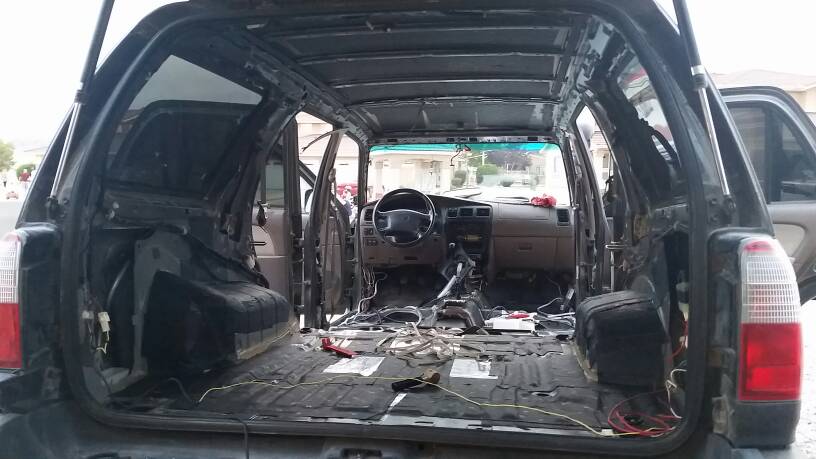

Take a look at secondskinaudio.com. Every now and then they have a sale on b stock stuff. Still better than dynamat any day. I got 90 sq ft for about 230 with shipping. I did the entire 4runner and I still have some sitting in a box.
I also did all the doors and the tailgate. Made a big difference in road noise and environmental. For reducing tire noise you can also attack it from the outside by using a rubberized undercoating.
Hope this helps man. I would NOT use spray foam. You will regret it.

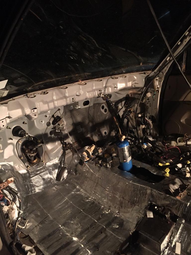

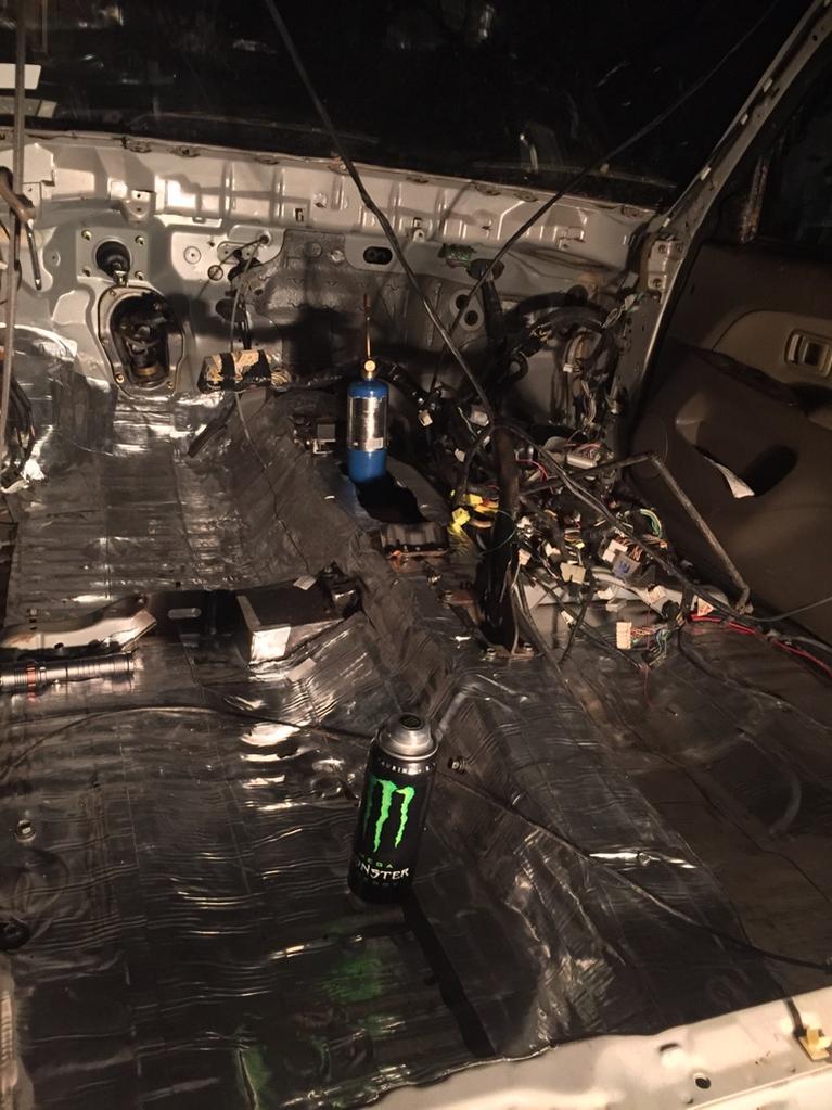

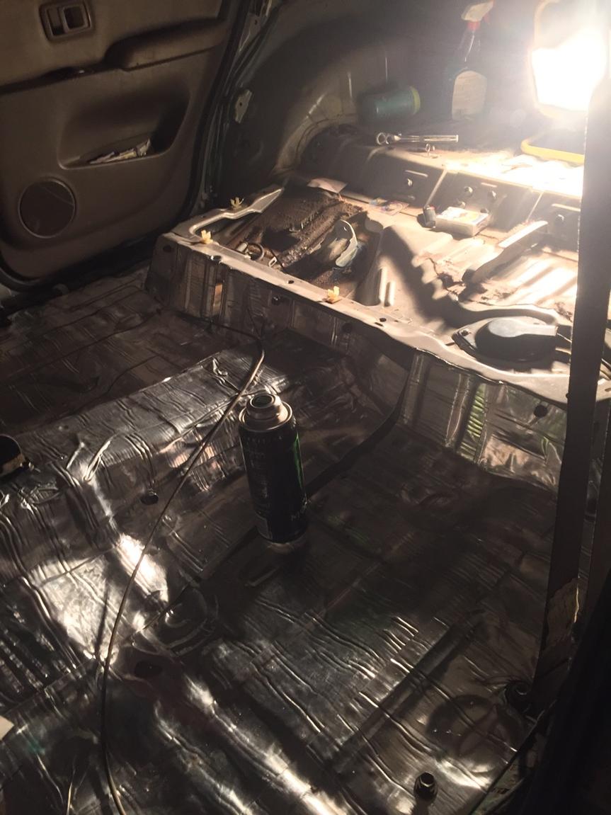

You can use "Peal N, Seal" from Lowes as well.
It's about 17 bucks for a 33 foot roll. I used two and a half rolls to do the entire passenger compartment, not the doors yet though.
It's the same thickness as Dynamat, 50 mils., and is BASICALLY the same stuff. Only difference being that it's an asphalt base instead of a butyl base.
I did it during the day and night, and one "trick" I found was to use heat on it, like a propane torch or a heat gun, to make it REALLY tacky.
This stuff sticks straight out, but using the heat makes it "flow" a little more.
I'm in NC, and it's been close to 100+ all summer, and, even though I DON'T drive my truck right now(working on stuff now that I have another DD), I can't smell it at all when I open the doors.
Clean floor pan, (I used Mr. Clean spray stuff) and go with it. Cuts fairly easily with a razor blade.
You can find it in different widths, though I feel the 6" is perfect to work with.
http://www.amazon.com/MFM-Building-Products-50036-Peel/dp/B0004I0MG0
Shop Peel & Seal Instant Waterproof Repairs 6-in x 25-ft Aluminum Roll Flashing for Chimneys, Roofs, Doors, Vents, Gutters, and Egress Windows at Lowes.com
I plan on getting some aluminum tape to go over the seams as well.
