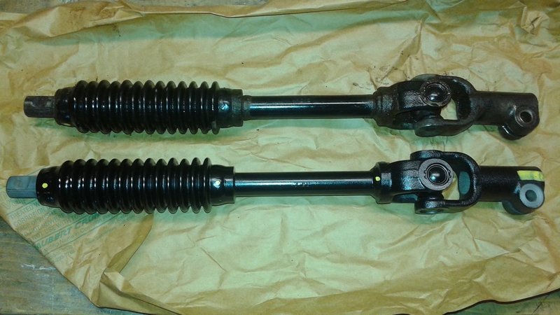

So I haven't been on here in a while...figured out the steering being stiff when turning issue.
The lower intermediate shaft on the steering column was seizing at the U-joint?
Here is a pic of what was replaced from a guy on tacoma world.
20150808_131024-jpg.752077
I didn't get to see the old one, wish they kept it so I could have gotten a picture of it for you. I needed to get to work asap so I took it to a mechanic. Not sure how it broke or if it's a common issue?
