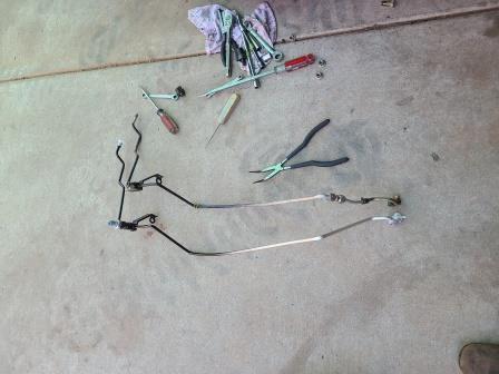

Expensive lesson learned: A/C line rubbing against winch
I am just running into the same issue with my 2022 TRD ORP - got the part number from a dealership the other day - The Air Conditioner Tube & Accessory Assembly (#88710-60G90)
I went through this few weeks ago. This line is stupid expensive at $180 at the dealership so if you can find one from a wrecked vehicle, i'd go that route. In my case, I had to move the bumper forward by <1" just so I can remove the bolt and separate the busted tube from the system. This was totally avoidable. New tube comes with O rings at each end but do remember to apply some PAG oil on them.
Look up on YT on how to separate the plastic union things that keep both hard pipes connected together. It's easy but takes some inside knowledge.
