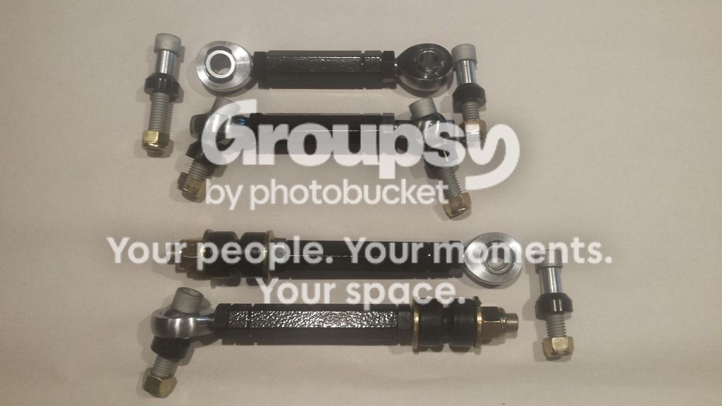

Built my own. Used the generic 4 inch kit from Autozone and done 1200lb working load galvanized eye bolts from Lowes. Worked great, handles great, cost me maybe 40 bucks.
Here's an example of my links. Boots can by added that'll completely enclose the heim.

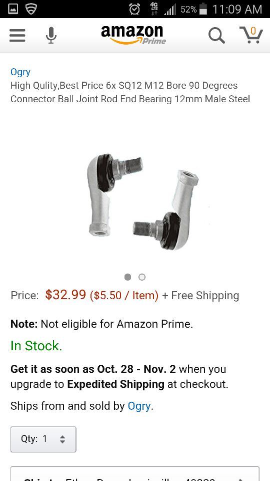

Screenshot_2016-10-24-11-09-06.png I found these for 6. I'm just going to make my own

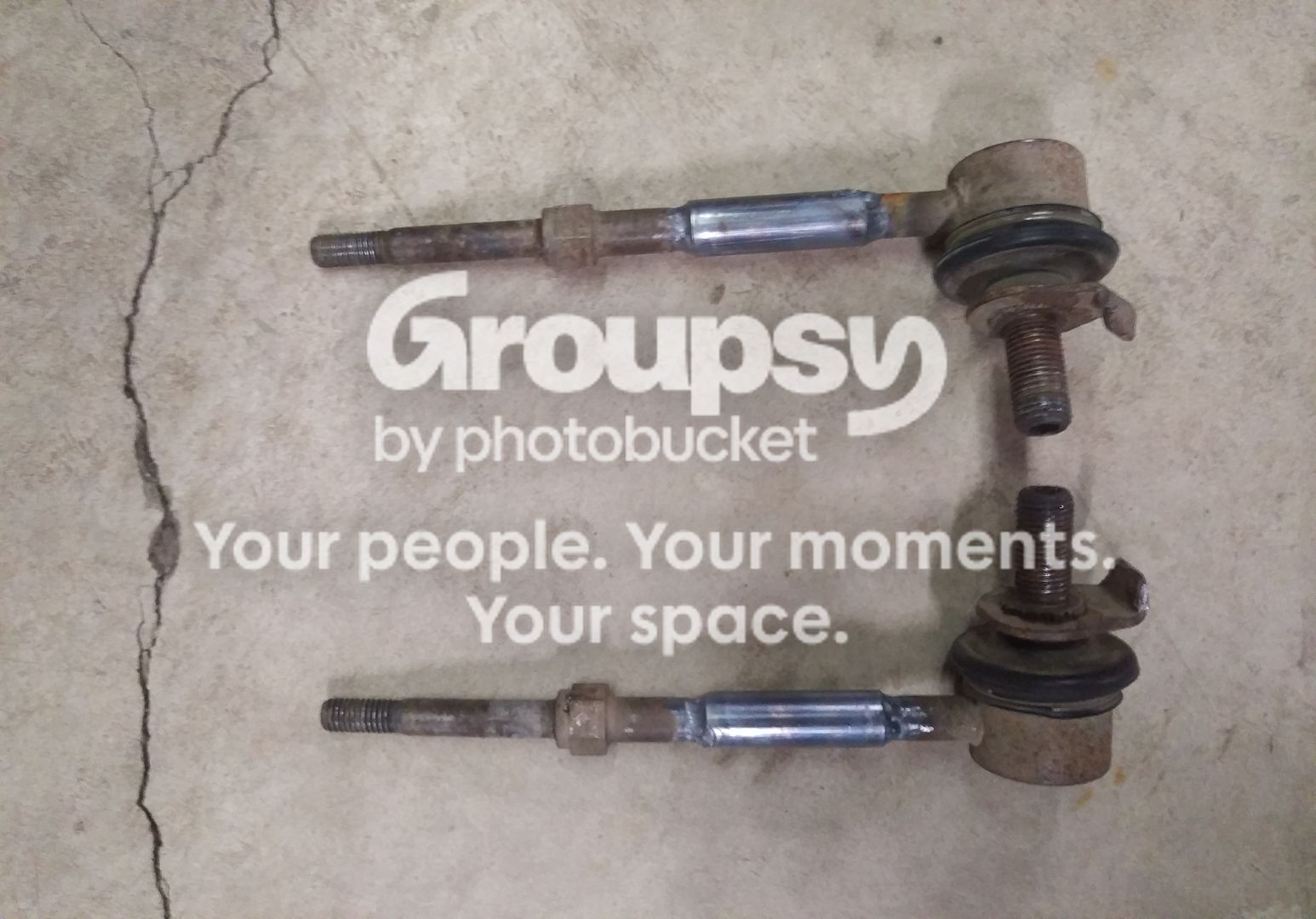

I extended mine in the rear by 1/2 an inch. Took about half an hour and works great. There's more detail on page 1 out 2 of my build thread.

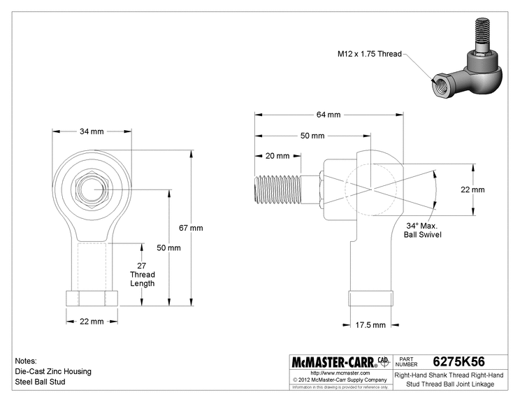

McMaster-Carr These are what I used but they were not as expensive back when I bought them . The stainless rod and hardware was something I had on hand so I used it. So far it's held up and it does get stressed as I never disconnect . If I ever break one I'll use some 10.9 rod instead as the galling issues alone make the stainless not worth it.
