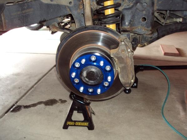

This doesn't look ideal to me:
iphones020.jpg~original
I couldn't determine from my search if the "newer" nuts sold with Spidertrax wheel spacers address this issue or if extended wheel studs are advised.
I found that picture in the "spidertrax install makes me nervous" thread. I havent actually purchased hem yet but want to see if I need to order extended studs at the same time.
I remember that thread. I believe this issue has been resolved and the community concluded that it was safe. Also that picture might not be accurate.
Post a real picture of when you actually install them.

Paddle, mine look just like Singtoe's. Flush. I have 1.5" Spiders on my 97. When I bought mine from 4WheelParts, I told them what rig I was buying them for and they told me what I needed to buy. The nuts they told me I needed worked perfectly and I've had 0 issues. If you order from Spidertrax, I'm confident you'll get exactly what you need. Don't forget the locktite.

Thanks guys. I will call spidertrax on Monday, but it sounds like I need those ET nuts, but at the same time it sounds like the All Pro ET nuts won't work. Hmm.
Why would you try to use All Pro nuts with SpiderTrax spacers? The spidertrax ship with new nuts. Just use the ones they provide. Case closed.
That recommendation came from those who installed spidertrax and only had 2-3 threads engaging on the spidertrax nuts. It's the reason I posted, there seems to be a lack of information about the subject.
i just bought me a set of G2 1.25 spacers, and they include the red locktite in their kit. and i had plenty of bite with the lugs they provided. the factory studs are long enough that they stick out about a 1/8" past the lug nut.
