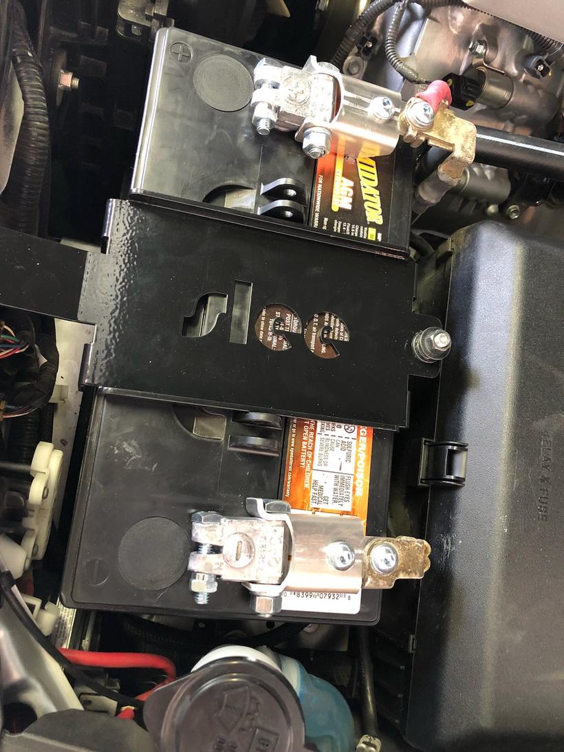

Group 31 Connectors
I have a set of the Slee connectors arriving today and should have them in tonight. I friend sent me a pic of his 200 Series and it appears the same as the 4Runner. This pic is the 200 Series with the Slee connectors.

It depends on which battery you have and the terminal locations. I got the stud convertors for my X2Power battery and they're still too far away.
i have a set of Slee's mil spec terminals and extensions that i wasn't able to use on my dual batter setup, if anyone is interested PM me.
For you guys running that Slee battery connector extension: anybody made a cover for the positive terminal? That's a lot of open area exposed to get grounded out.
