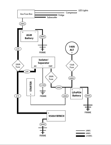

Putting a schematic together to validate all the segments and materials needed

Here's my current wiring plan, the next step is to temp it out on the truck to double check all lengths against the gauges I plan to run
All critical load fuses are ANL blade type

My schematic is posted above and based on my mock up of the wiring, the 2/0 run should be under 15 feet long, total length
Additionally, I pulled trigger on Blue Sea AGM fuses and holders
150 AMP between the alternator and start battery
200 AMP between the Isolator and each battery circuit
