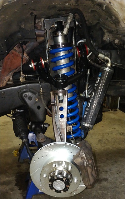

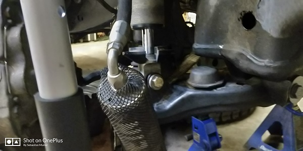

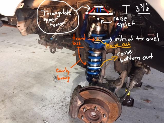

Nearing 1 year UPDATE
After having driven for quite some time on this setup, many miles logged, a 7,000+ mile trip out to explore Colorado from Georgia and back, 1,300+/- offroad miles, and countless trips to the Chattahoochee National Forest of North Georgia here in my backyard I have decided to continue forward with this front setup. Initially I thought about a long travel setup and I will eventually get there, but with the 4wd conversion being done this winter, I also wanted to re-gain the bump-travel I lost when adding these longer CO's . I will only be raising the effective upper eyelet height, BUT I will go just a bit further than factory to maximize my bump-travel.
How: I would like to either plate the coil bucket and modify it to create clearance for the 2.5" body to sit 'inside' of the coil bucket and using a double shear eyelet mount, hopefully raise the shock body to where I have maximum bump travel.This triangulated top mount will definitely be strong enough to withstand the forces applied to it (more so than the factory bucket)
I will be able to use the modified upper mount and at the same time use the Factory LCA geometry to keep the same wheel track width. I hate the idea of 7" wider overall with LT and I have had the urge to build something that is a true Mid-travel design using the Uniball UCA's that we all know and love and without the $$$$ that Long Travel wants from us. I have 8" of shock stroke available to me so, I intend to use most, if not, all of it!
Stay Tuned!

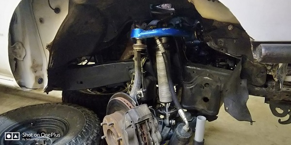

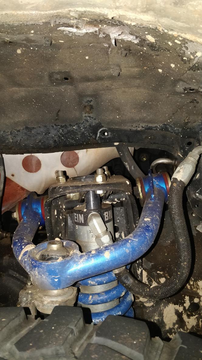

Update a few years on...
It's been nearly 4 years

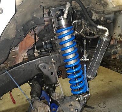

I installed these coilovers on a 2wd vehicle and I ultimately went through and painstakingly thought through how I would go about designing this mount to get all of the travel back out of the factory suspension.
Problem: I lost a few inches of up-travel due to stuffing an 8" travel coilover in the factory location.
Solution: Design a new mount to go in the place of the existing tower to get that travel back.
How:Prayers and CAD.
Commitment:

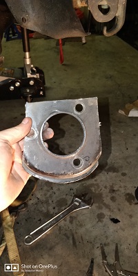

Photo dump
Problem and starting to get to the solution
Chop, chop, chop

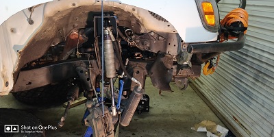

Fitting and measuring
All of the work for figuring out the material thickness, width/length/etc. of the tower will be done in CAD, but I was getting the clearance for the coilover done with grid board.

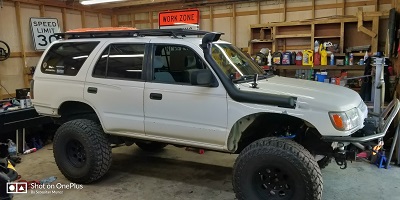

4Runner May Update
Here's a photo for reference after I had chopped the fenders and attempted to fit the 35's without tubbing.... Laughing at that now!

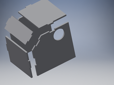

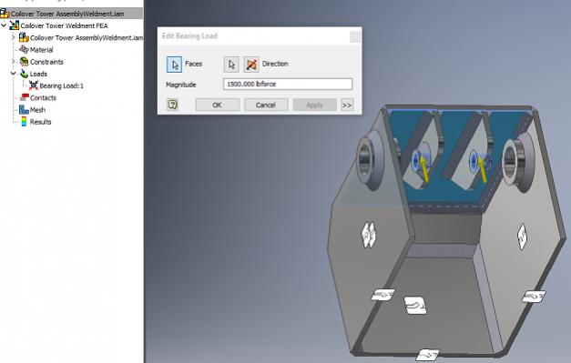

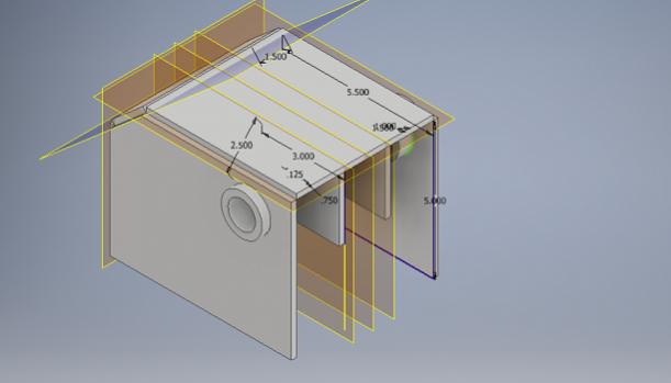

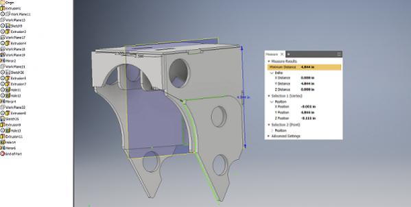

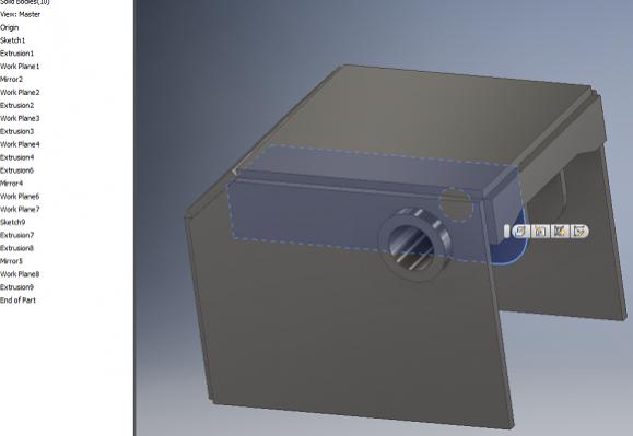

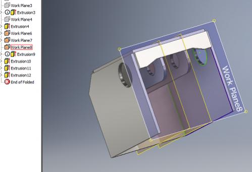

Here's some fun on the computer
This is sort of the progression after doing the finite element analysis for the mount. I sort of know what I'm doing, but I'm only just scratching the surface.

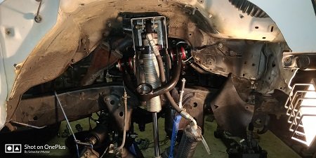

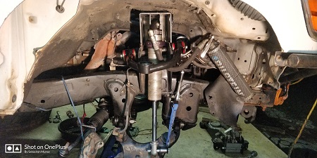

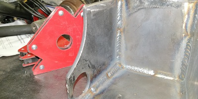

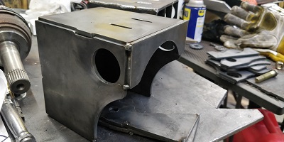

Update: CNC done on the prototype and some refinement
Got the CNC to cut the parts out, tacked together, and fitted to check the dimensions. This is a very crude version and you can see that I took lots of material away afterwards and added some cleaner lines.

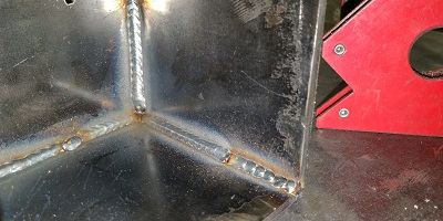

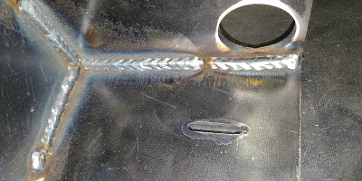

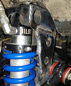

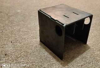

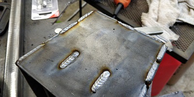

Update: New parts cut
Got the final part cut out, and tacked. I couldn't wait any longer so, I just got after it and started burning.

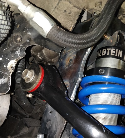

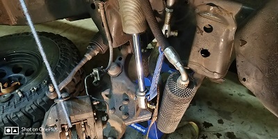

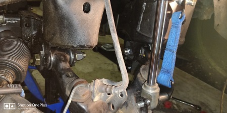

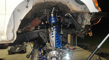

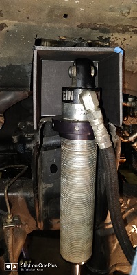

Putting it back together
Re-assembly time with all the new shiny parts
