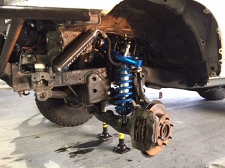

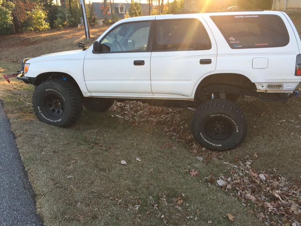

Looking real good, that reservoir is a beast! I'm thinking doing a similar setup pretty soon. Was the picture taken at full droop without limit straps?
Yes that was full droop no straps... YET. Anyone know if these have been run on a 4Runner ever before?
I haven't seen anyone run 8" shocks on stock suspension. You may be the first. Also I'd like to see full compression if possible.

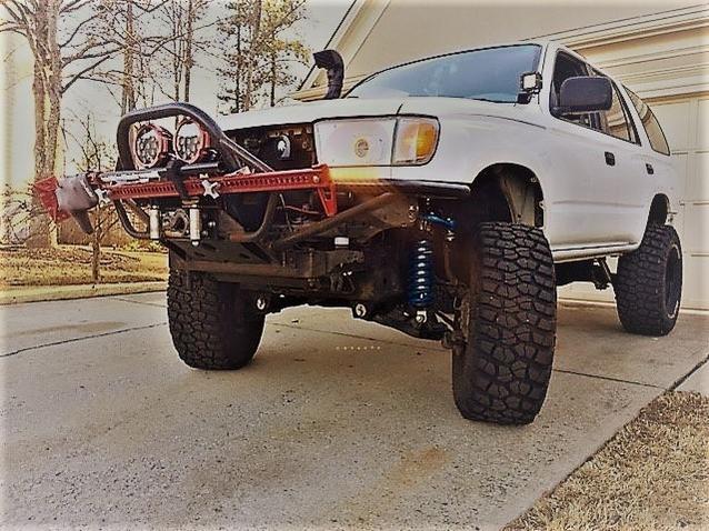

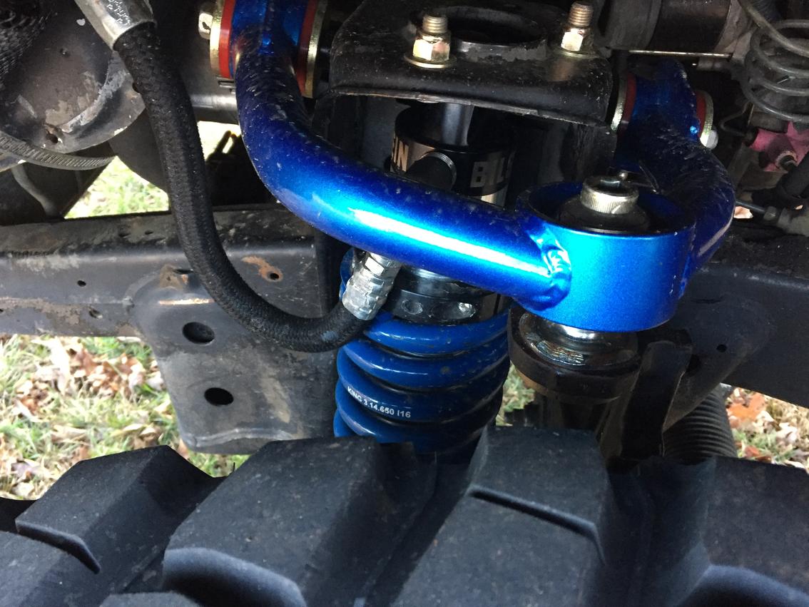

Tomorrow... (or I guess later today) I will test out a bit of the full compression of these CO's and see where I am bump-wise! I am still waiting to fork out money to finish the front end off with front bumpstops and limiting straps! So far around town the CO's have been far smoother with small bumps over the previous Toytec Ultimate CO's. Over larger bumps the improvement is even more exaggerated, the rebound is more controlled and the front end of the 4Runner seems to make its way back to ride height without any bouncing whatsoever. In other words, rebound feels DIALED right away, that has been the stand out improvement! Other than that, my springs tend to creak quite a lot more than before. We just had some snow and salt on the roads which can be a factor, but I have washed the rig since then with little improvement. I am also making sure to lubricate the rod ends on the CO frequently along with my UCA's. 126174r.jpg

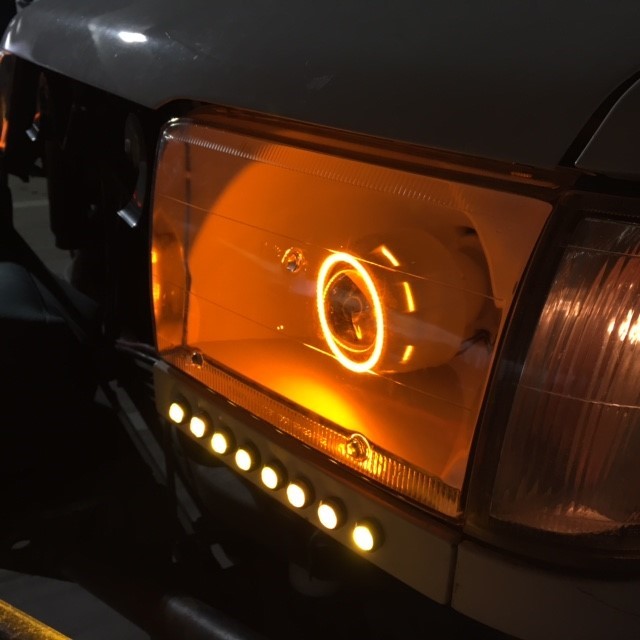

I got a bit creative over the college break and decided to make a long overdue change ... retrofithalo1.jpg
All done! :dancin:

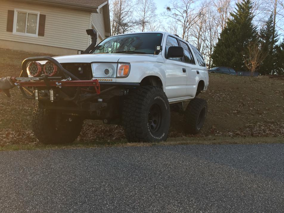

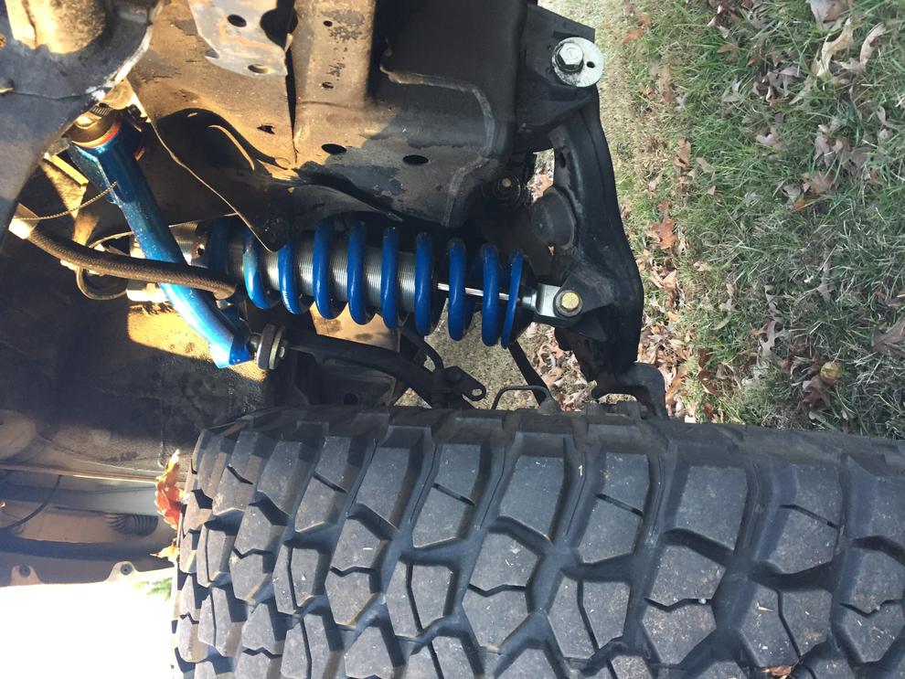

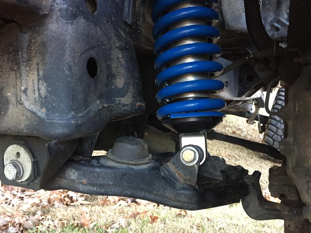

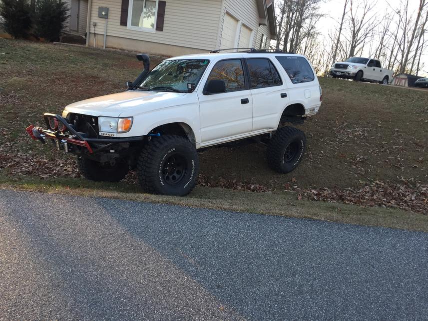

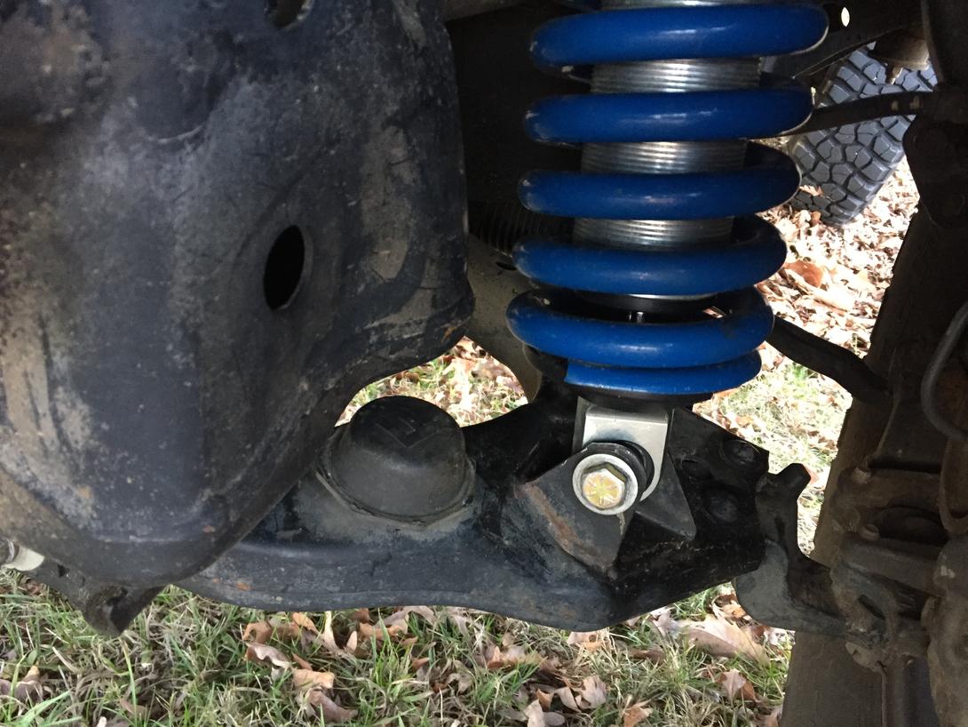

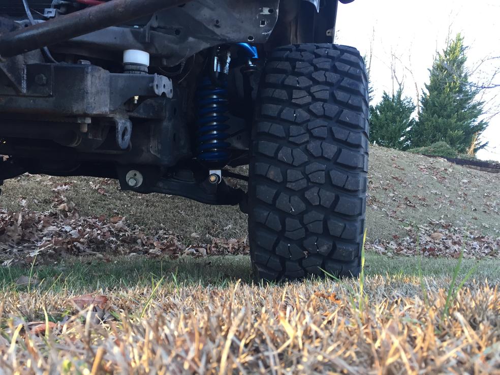

IMG_6400.jpg About 1 1/4" shock left before extended bumps.
Overall very pleased with the front end and rear end equally. I was surprised at the travel amount on the front (useable travel.
Extended bump stops should take care of how close the shock is to maxing out!
I will try to upload a video of the CO's over bumps and the rebound of the 4R.
