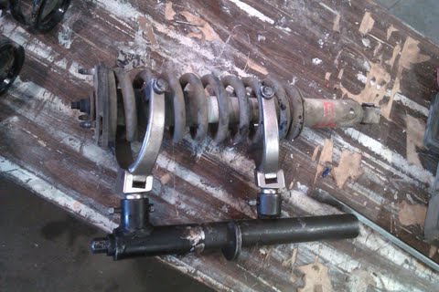

Since you are going to be getting an ARB I would go with the 99's. Your going to have to take apart your struts anyways so you might as well put the taller ones on, so when it sags it will still be higher. You are definitely going to have some rake, but shouldn't be horrible.

i got a set of 99 tall coils and struts for the front, that im gonna use(cause of the added weight) till i can get either a set of tundra struts or some toytecs, i also got some 9wraps (all for $40). i passed on getting the MTRs cause my bighorns are doing just fine and still have a lot of life left in them and i couldnt justify spending $1200 on that right now. as far as wheels im sticking with the 17 tundra wheels i have now.

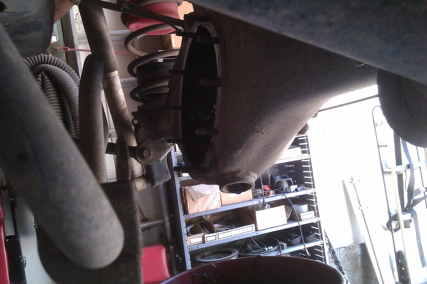

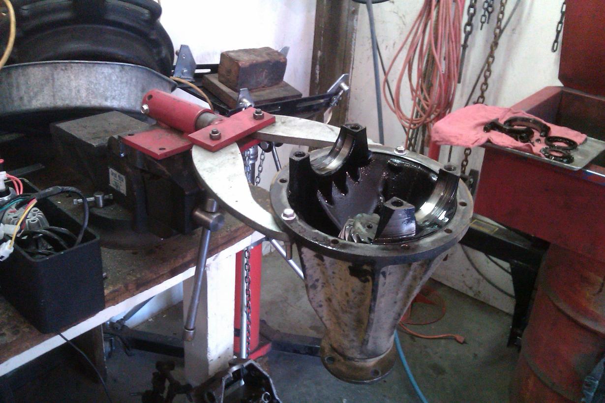

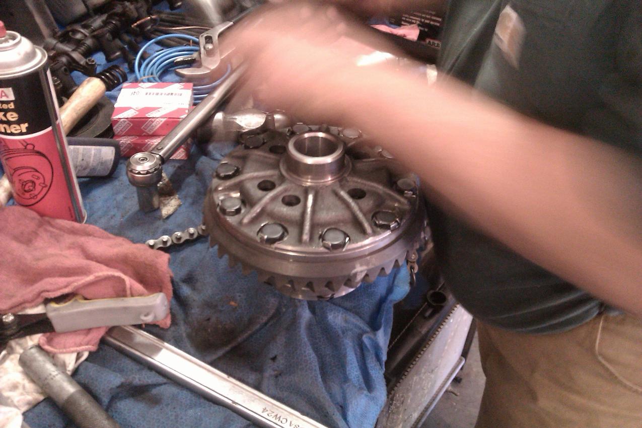

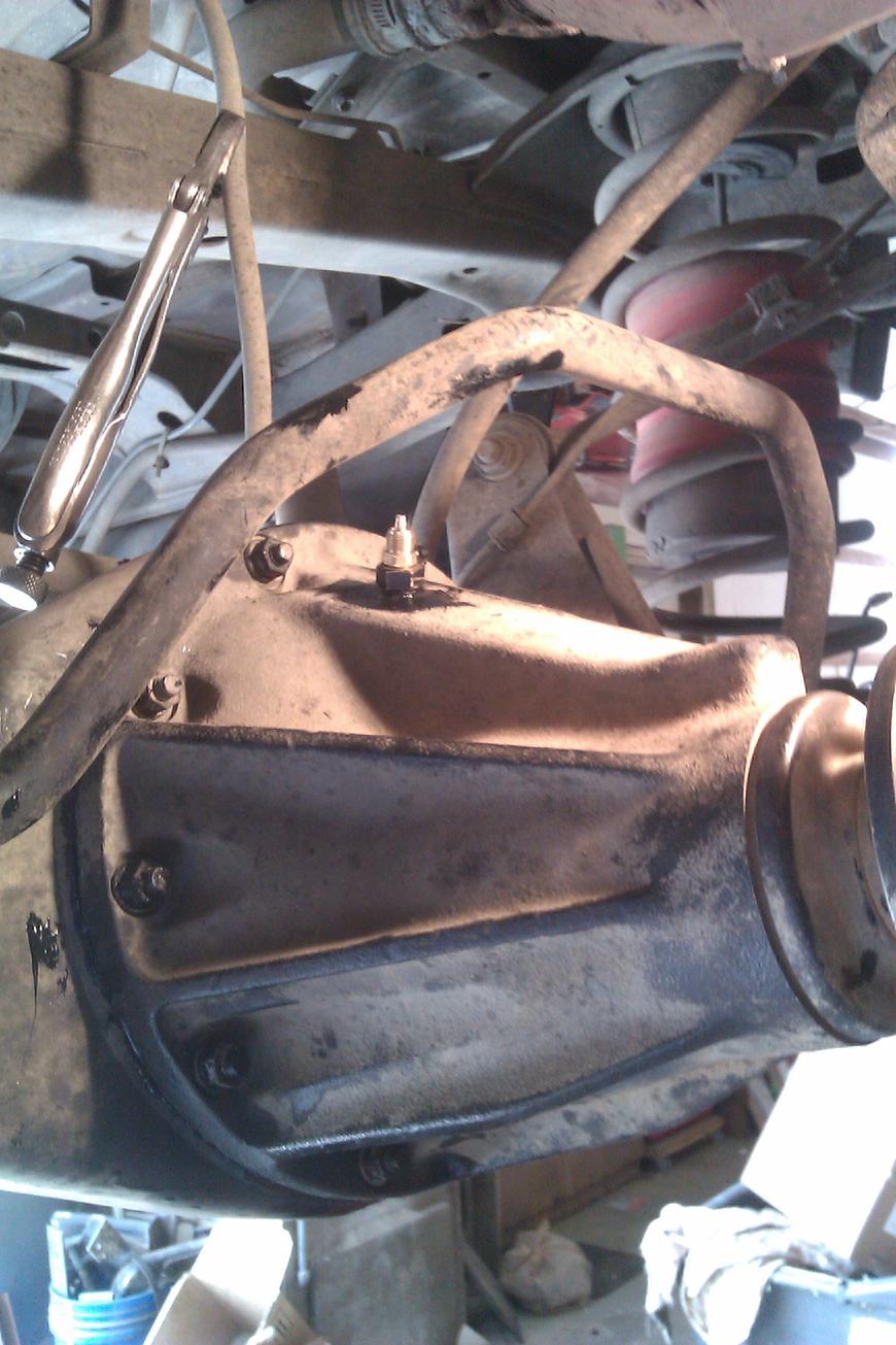

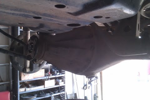

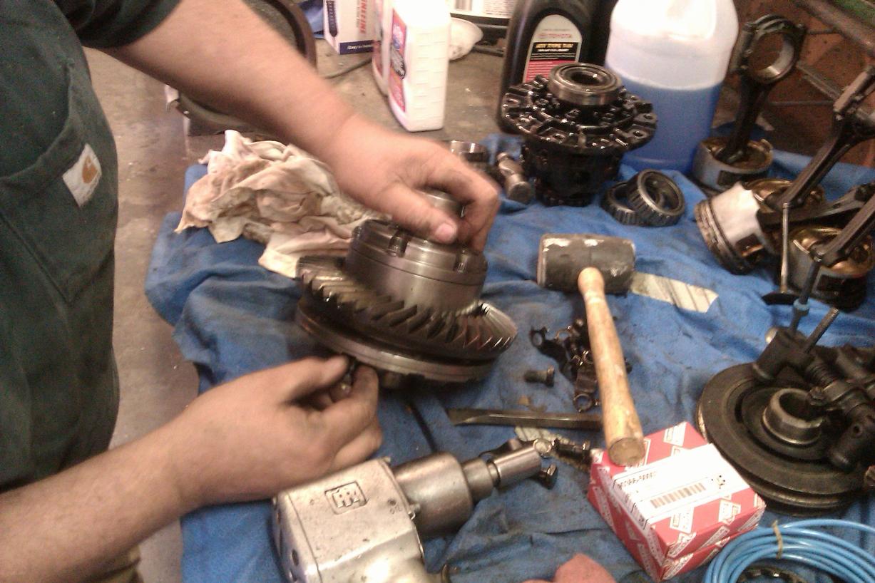

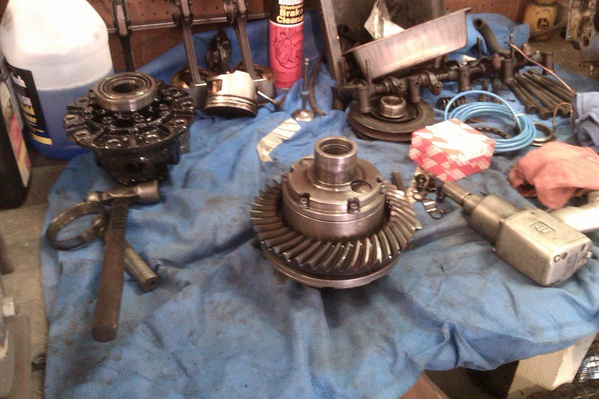

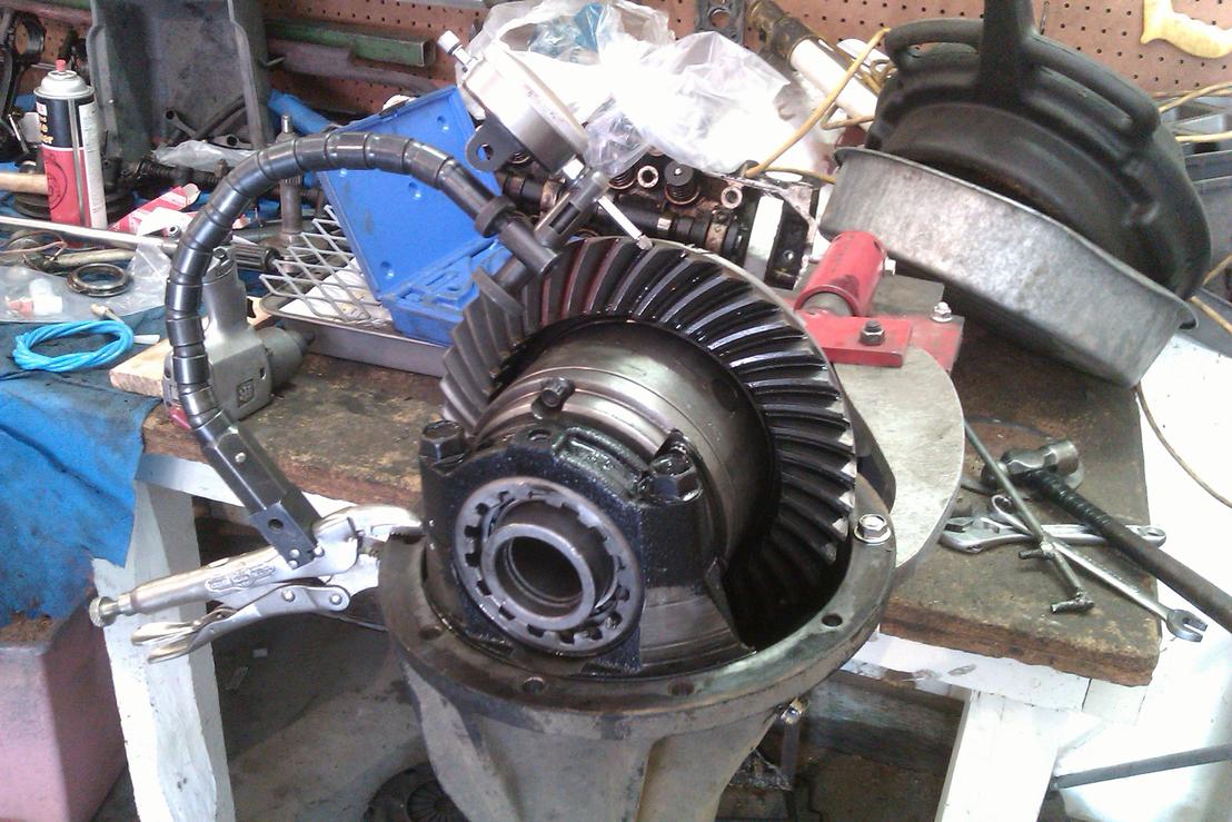

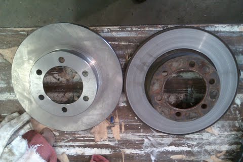

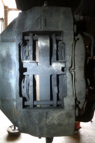

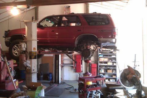

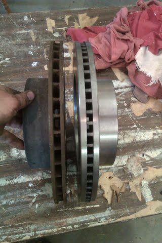

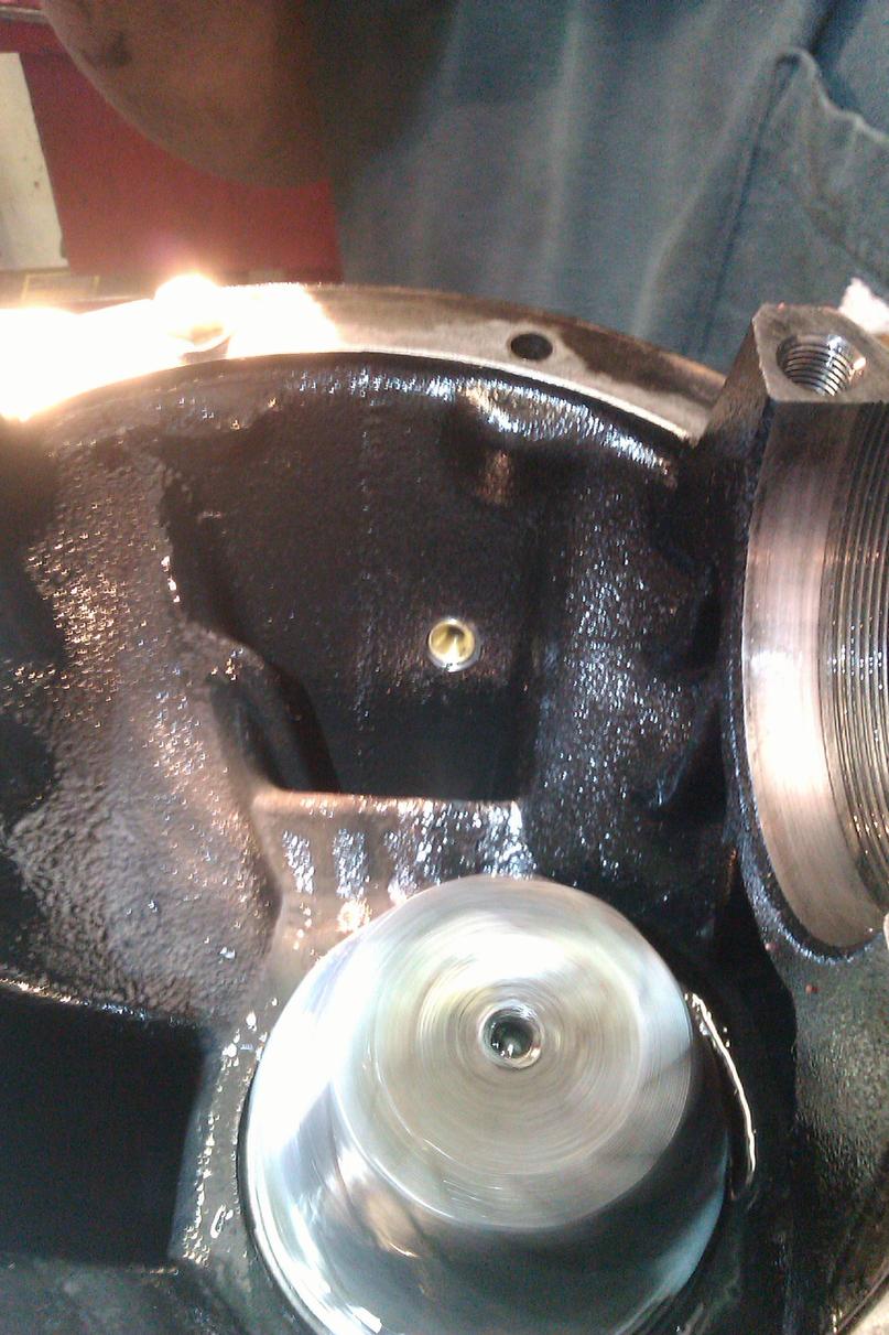

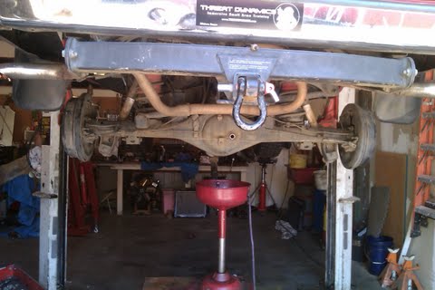

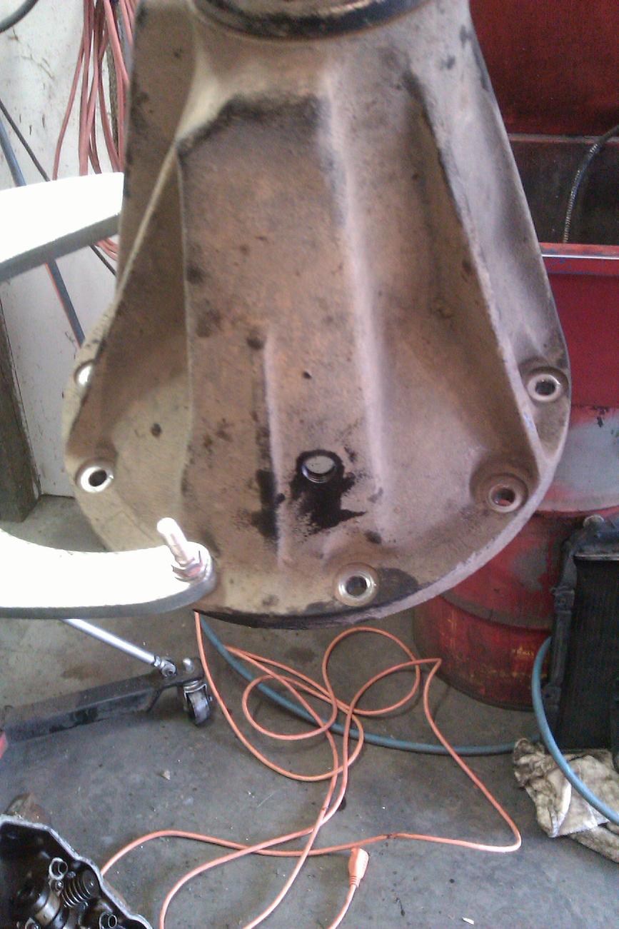

here are some pics from the instal

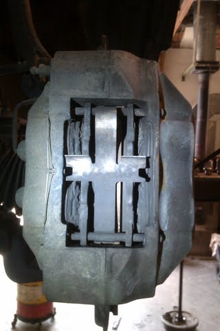

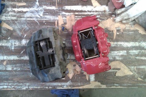

so you think my old boots where melted enough... i think it was about time for new calipers anyways...

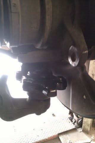

sorry for the bad pic, but this is one of my new LBJs the onld ones were still good and had no play so i will keep them as spares for wheeling trips...

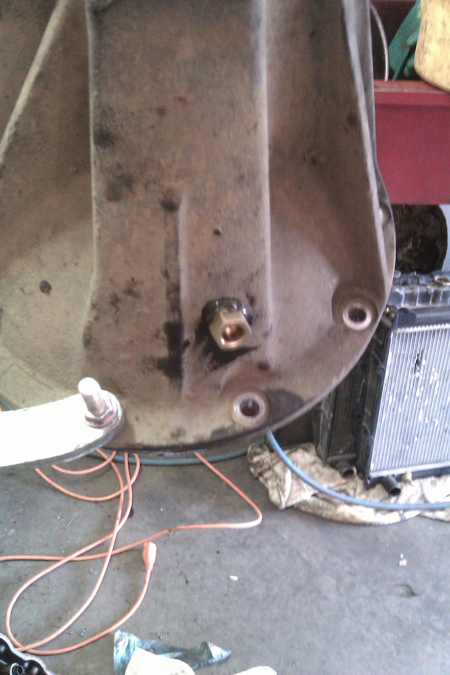

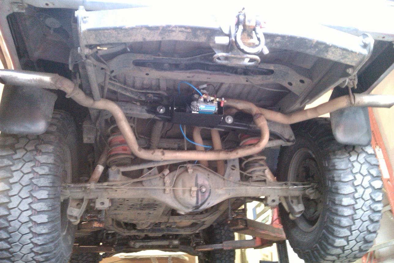

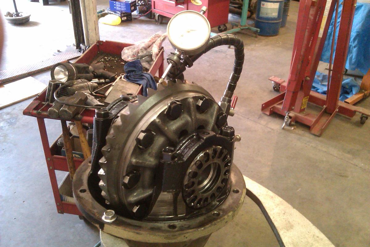

if you look at the way i ran my air line(the blue hose) it clears the exhaust at this point but all the extra slack pushed up on to the the left pipe just after the muffler and melted it... i have sense rerouted it and fixed the issue. and on a side note, for those of you wanting to run an ARB in the rear, when wiring in the switch for the locker if you are only using one ARB you have to wire it into "switch 1", if you try and use "switch 2" with just one locker it wont work, i spent like a hour today chasing down why everything but the solenoid wouldnt work, it was cause i was using it on the wrong switch...

no not yet, i just got it working today after work... i bench tested it yesterday before putting it in to make sure the locker worked(as i got it used -i have less than $600 into everything for the locker, compressor, fittings, bearings, seal, and locker!) so it was just a matter of tapping a power source(already had a spot for it), and pluging in the switch. as soon as i got it working and tested it out on the lawn lol -my wife didnt "lol", and the street, i wanted to go run some trails so bad, but if it rains tomorrow i wont be working and will got find a trail to test it out on!
