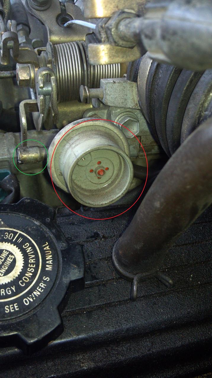

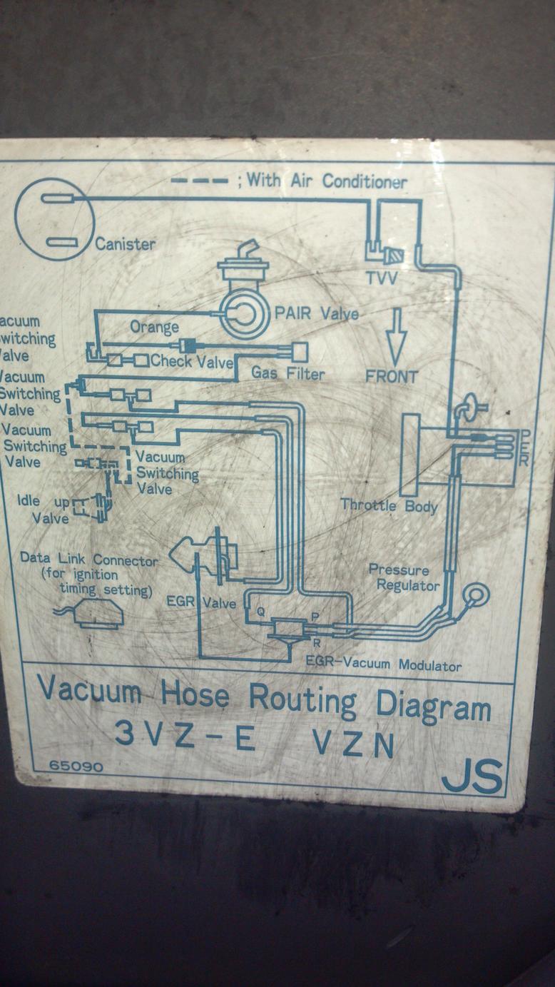

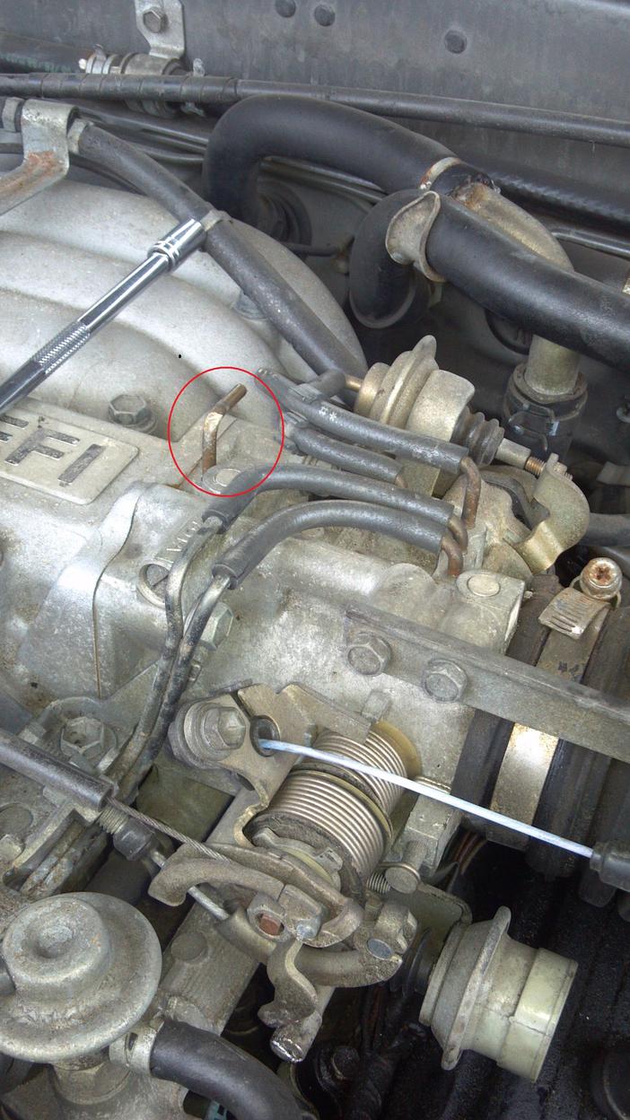

After my friend finished replacing my timing belt, a pump and my radiator we noticed an extra vacuum line on the throttle body that did not have a hose or cap on it. I can't see where it is on the diagram and don't know where it is supposed to go. Does anyone know what I should do with it? See red circle below. 2013-03-09_15-15-10_498.jpg

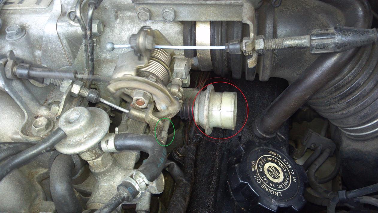

In addition to that I had some issues with my idle rpm dropping to 500-700 causing the engine to shudder, after the engine has warmed up. I have a sensor next to the throttle line that looks like it is missing a cap or attachment. It is connected to a rod that gets very hot and is on the other end of a rod that I assume adjusts as a backstop for the spring/throttle wire.
Red circle - sensor Green circle- rod
Am I missing any pieces here or is there something I can adjust to fix the idle issue?
Thanks for any help.

the vacume port should be plugged, the second picture is your dashpot and is missing parts that is probably your idle problem
