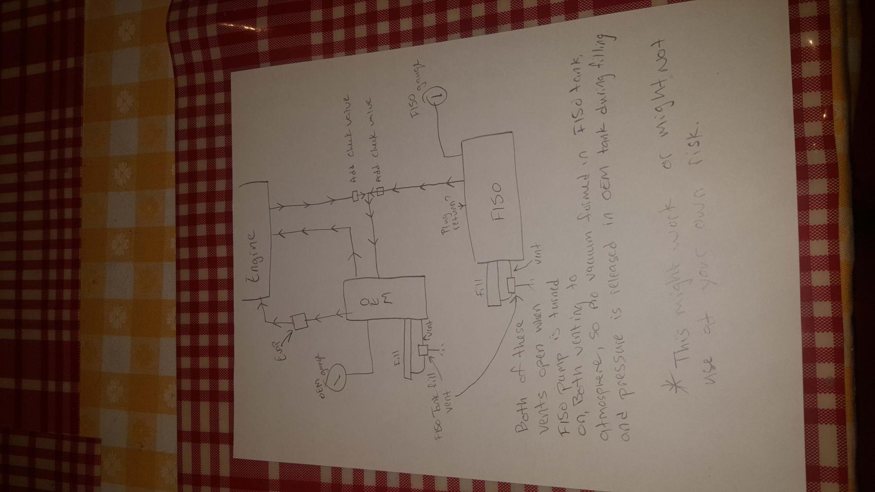

As for hooking it all up, I'd suggest running it as a separate tank. Thus all you would need is a filler neck, a vent (don't hook that up to the stock one), and use the f150 pump/sender and a separate gauge. And plumb the ford tank feed into the oem return line, might need a check valve to prevent the oem return from filling up the f150 tank.
Problem becomes when you pump in the fuel, the oem tank will get pressurized so maybe a solenoid vent? One that only vents when power is applied to the f150 pump. Manually shut the system off when your gauge reads full.
From what I have seen it's a PITA to run it as a dual feed tank. I drew a pic, don't know if it would work or not so use at your own risk.

Didn't think about plumbing it into the return line, that's probably a lot cleaner. Why not tie into the stock vent? If you keep both tanks are connected through the vent and maintain integrity at the filler and gas cap, would the EVAP system just see it all the same? If the 2 tanks vents were tied together, wouldn't the pressure of the tank being filled offset the vacuum the other tank (check valves may not allow this)
Hmm if tying the 2 filler vents, those are primarily used to vent during fill ups. The hose goes from the top of the oem pump bracket to the top of the filler neck, it's what helps stop the gas pump when the tank is full. But it may work to equalize the 2 tanks during fuel exchanges. The evap is only to keep tank pressure in check during vehicle operation, there is a check valve on the oem tank that will somewhat prevent the evap canister become fuel soaked if you keep clicking the gas pump.
Most of the transfer tanks I see are on semi trucks, which just vent to the atmosphere and pressure differences just vent off. Back in the day when I had a 1jz swapped cressida, I vented the tank into a charcoal canister then to atmosphere, but I was running a standalone ecm.
Or a even simpler solution, hook the ford pump/sender to a manual switch and run the feed hose into the filler neck of the oem tank. Don't tie anything into the oem system. It would be like pumping gas from a Jerry can. You would need to figure out the filler neck.
I like your idea of dumping it into the return line, using check valves on either side of the tee. Don't have to mess with the filler tube at all.

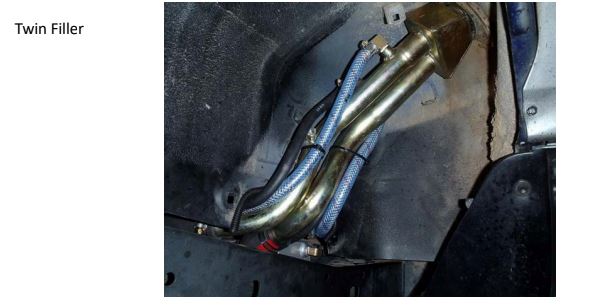

There are different types of filler setups, the 4th Gen one basically Tees the two tanks together I think. The twin filler they use for the Surf has 2 channels that you slip the nozzle into based on which tank you want to fill, but they are still combined at the cap. I have friends with this set up on their Mitsubishi Pajero and have had no problems. It set up for transferring between tanks, but that inlet could be capped if you went the dual tank route (now the way I am leaning...). If only I could get them to sell me that alone (without breaking the bank)

It looks like the Long Range option is for a diesel, which has a slightly different fill neck. Might be a reasonable place to start, but it will have to be modified.
