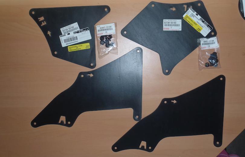

Here's a picture of the shapes, it would be hard to get size for scale but may still be helpful to anyone trying to make them from scratch.
Not sure who took this picture, I got it from momo.75 but it wasn't his.
Those are the fj ones that I wanted to try. I don't have the oem ones to compare them to. If somebody that doesn't want to make there own want to try them here is the link.
According to Toyota Parts Zone, they're the same part number for FJ & 4Runner.
edit- sorry, just for the front guards are the same
here's a photo of the 4runner rear guard, I'd guess that the FJ ones would probably work well enough for a template.
