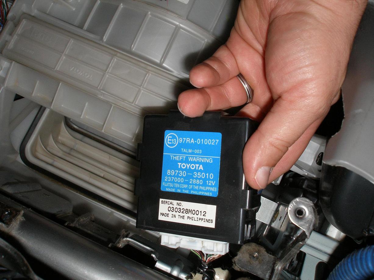

Having the limited, you SHOULD have the Toyota theft deterrent system installed, not just the keyless door lock system.
The theft deterrent module is located above the glove box if you want to check it out. Here's a picture of mine. If you have the theft deterrent system, you can actually add sensors to it. I added a glass break and shock sensor to mine.

That's probably an aftermarket alarm system installed at the port or dealer. The factory "theft deterrent" system uses the factory security lamp located in the HVAC control unit.
Many dealers/ports install these before selling the vehicle, it's little more than a cheap alarm system so they can justify charging the customer more money.
