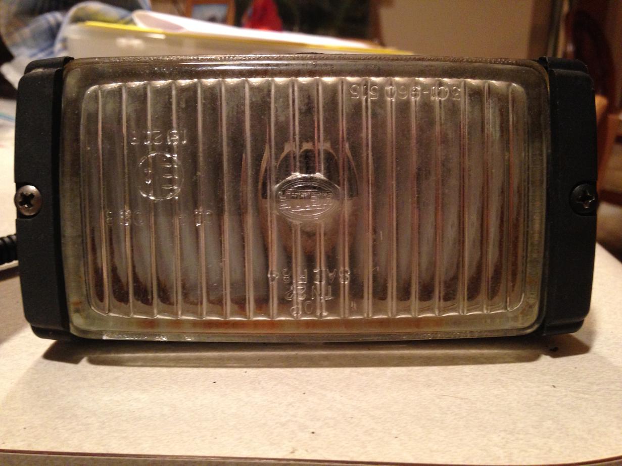

Do your foglights look like this:

Hi Scott,
Your photo didn't come through. But here is a photo of what my fog lights look like:
I see. The ones I was thinking of are for the valence on the fat lip bumpers, which are on the 99+ 3rd gen models. When I saw "Hella" on your first post, I was thinking that they were from that model. Ignore my post.
