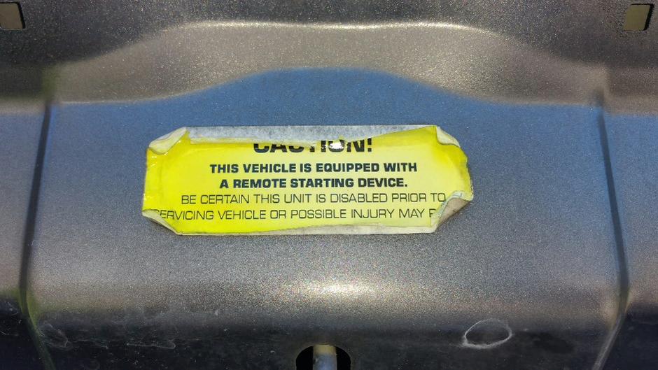

I didn't think I had remote start on my 2010 LE, but I just saw this under the hood. When try to do start sequence on the remote, nothing happens. I press lock twice and hold the third time.

Is there a antenna mounted on the windshield?
Turns out the P.O. installed an aftermarket remote starter by Audiovox. The only documentation I found in the glove box says to press the correct button sequence, but I doesn't say which the buttons to use and in which sequence. :redbrick: Doing some research on which model it is so I can find a manual.
Try lock x3 or lock, unlock, lock.
