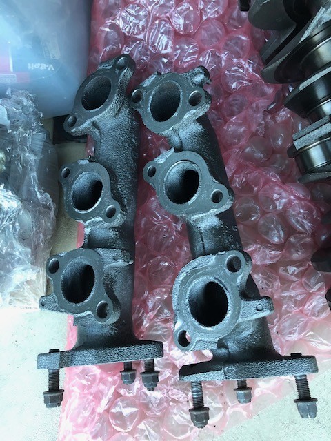

I painted the headers cast iron.

Have you thought about getting the exhaust manifolds resurfaced? That is if you are reusing them.

I was thinking about doing a few light passes on some fine grit sandpaper, but I don't think they are too bad. I may take them to a shop to check surface "straightness."

I did bead blast the exhaust manifolds and the intake manifold and intake plenums to make it more presentable.
