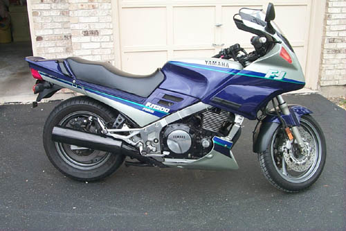

The Legends Cars are cool. I had a '93 FJ1200, years ago. One of the few bikes I regret selling.
Not a pic of my bike, but it looked exactly like this.
