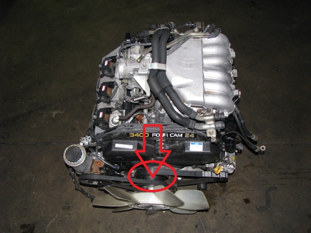

This is it...
This is the pulley/part I need.
Anyone know the part number or has changed it out before.

This is the part you are looking for:
4 Runner T100 Tacoma Tundra 3.4L Aisin FBT004 Engine Cooling Fan Pulley Bracket | MacAutoParts
Loosen the tension until you can get all three drive belts over the fan. Remove the fan and fan clutch as one. Inspect both the inner and outer fan pulleys such as the hole diameter for possible culprits of looseness. Spin the fan bracket. Three bolts gets it off. It may be a good time to check the water pump for leakage as well as possibly think about a new fan clutch. And watch out for spiders. I saw some baby spiders sacs under a neighbor's car while changing their radiator on Labor Day.
I think I have a fan clutch here. I think the bearing is NSK. If I can see the bearing number, I will post it.
