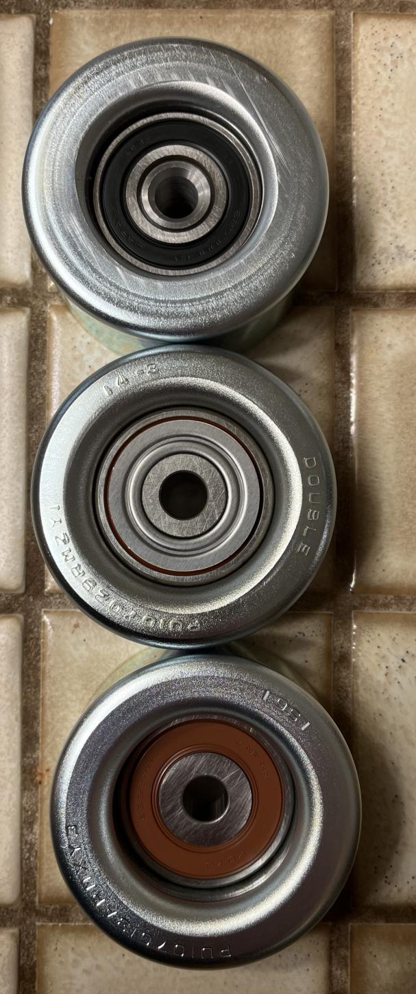

Not the same as either idler.

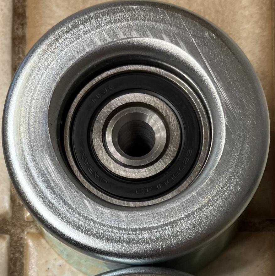

Here ya go…
NSK 6203DUL1B
17x40x12mm Rubber Seal
