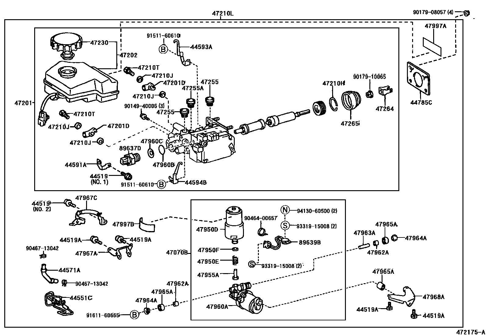

First share what the problem is with your brake booster, by reading the DTCs from the dash lights, and let us know and describe the symtoms, I will try to find some info and part numbers for the parts that you may need once you diagnose what the problem is.
Here is a diagram of the brake master I think you have. and a link to all the parts you can try to search for, after you find which parts are to be replaced or repaired.
http://toyotamarket.ru/us/671460/011/2/4702/1/47950D/
You can look up your catalog code in the link below if you want to be sure you are looking at parts for your 4Runner. The catalog code of your truck should be something like this RZN18xL-GKPxxx or VZN18xL-GKPxxx. Look for it on the driver's door sticker.
