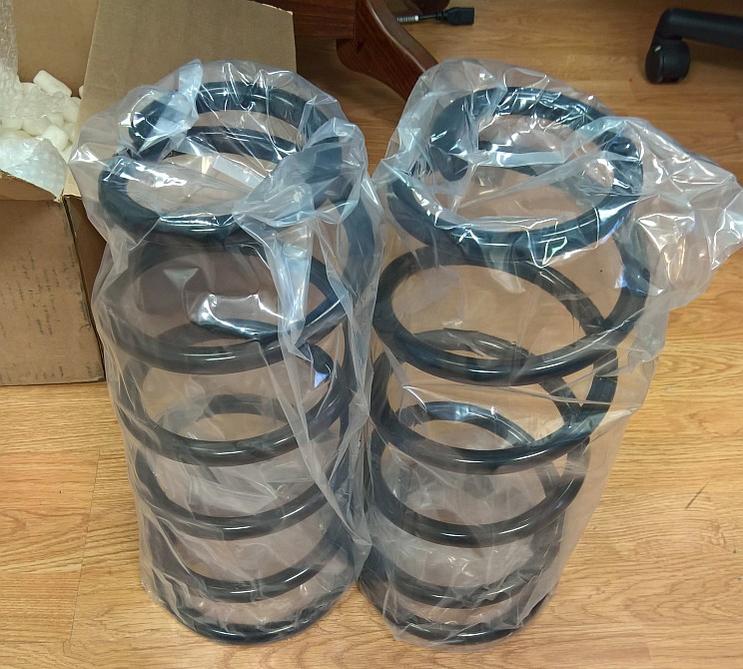

Mine are on a UPS truck instead of my truck. Hopefully the situation will be reversed by this weekend and I'll give you some feedback.
Plan was to install them tomorrow, we'll see. I'm wondering how well they will pair with the Taco O/R shocks I have.

installed with 5100s. The ride of the 195 lbs coils and the 5100s was really nice. Paired with the front trd 5100 set up it rode well. With 1.5" of front lift the t12s delivered around 1.5 to 1.75 inches of lift which is more than i bargained for.
The t12s hit the sweet spot in terms of there spring rate IMO. :hippie:
Mine are in. After some 30 miles of very varied driving, I think they ride better than the FJC rears, but also need more shock - too floaty on the highway. My Tacoma TRD O/R shocks apparently aren't up to the task (also I feel they are too short).
