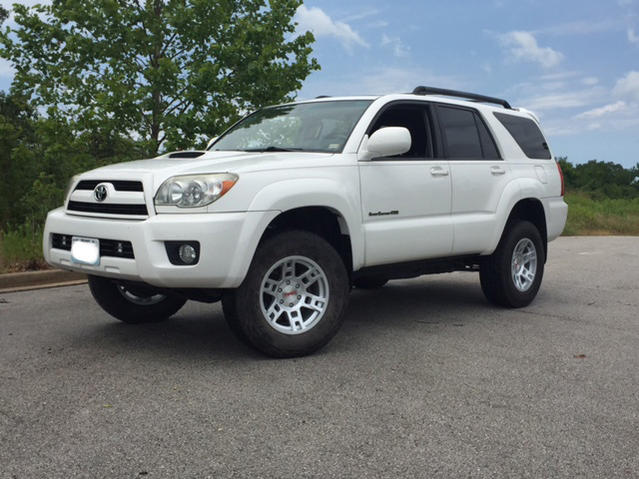

I took measurements again yesterday and it seems driver side is now much closer to 1.5" however pass side is over 2" ?? I've been busy but when I have time I'm going to level the front with some trim spacers I got and then if there's still a big difference in the rear I'll add a trim spacer to the driver side.
Here's the stance now (well, yesterday)

2 weeks and 1000 miles later still at 2" (both sides are even now).

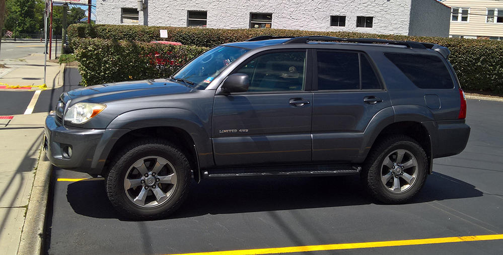

I'm very pleased with them. I have them paired with Fox 2.0" shocks, and they ride much better than the FJ / 5100 combo I had previously. As far as lift, I do think they settled in the 1.5" - 1.75" range, although I haven't measured recently.

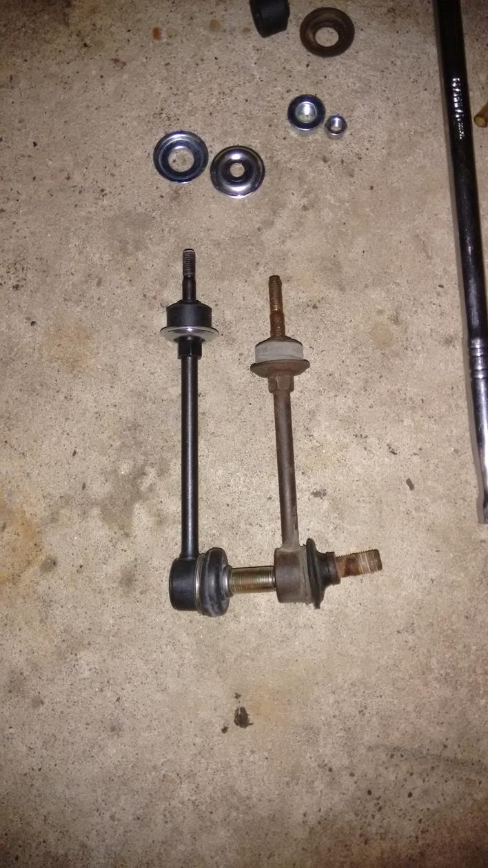

I just installed the longer links and I'm concerned there's very little clearance between them and the lower arms, it looks like if I bottom out the arms will hit the links. I hope I'm wrong.
Also I thought a lot about the geometry of the whole thing and I'm not sure they will actually accomplish anything but we'll see on my drive home tonight.
EDIT after 30 miles hwy drive
I can't honestly feel a difference.
When I took off the old links (which were only 2 years old and already rusted and one was bad...) the swaybar was pretty loose (I could easily move it by hand) and under no tension, which is why I am not sure this mod does anything. But it's cheap and easy so whatever.
