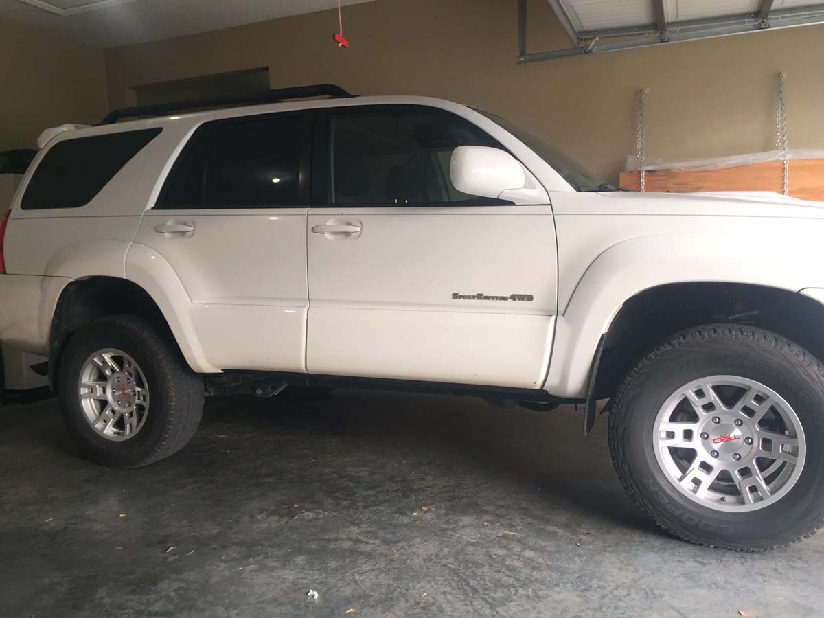

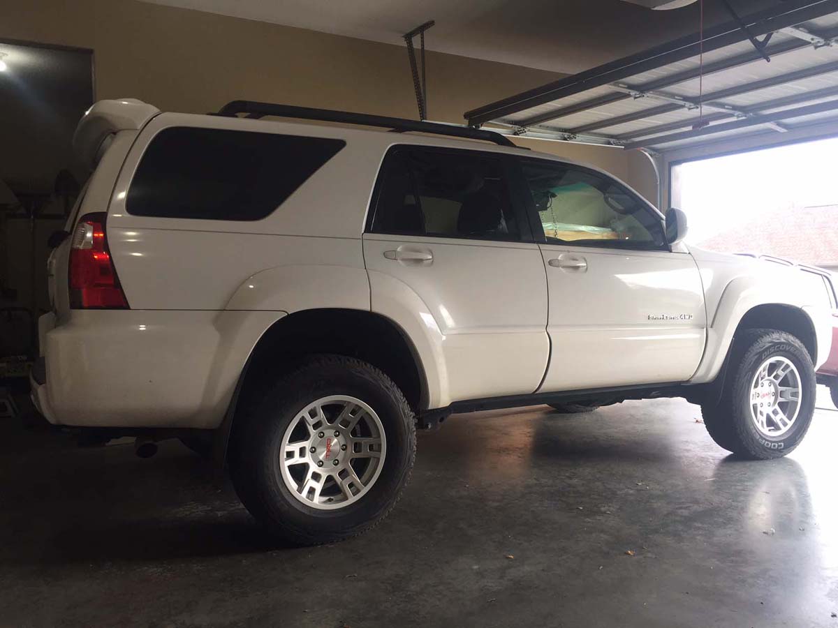

The rig looks great.
I was thinking of adding the 10mm spacers to the rear when I switch the front out.
I was looking for a little forward rake. Or do you think that T12's alone give you some rake?
You will have a slight forward rake. Which is what I wanted. Def didn't want negative rake. If you put anything in the back at all and it's level. You would have the front end high.
I actually have a custom storage box back there and still got some rake.
Any pics? I've read the t12 are higher then the 1.5 its suppose to lift.
Here's a couple of quick and dirty ones to give you an idea:
